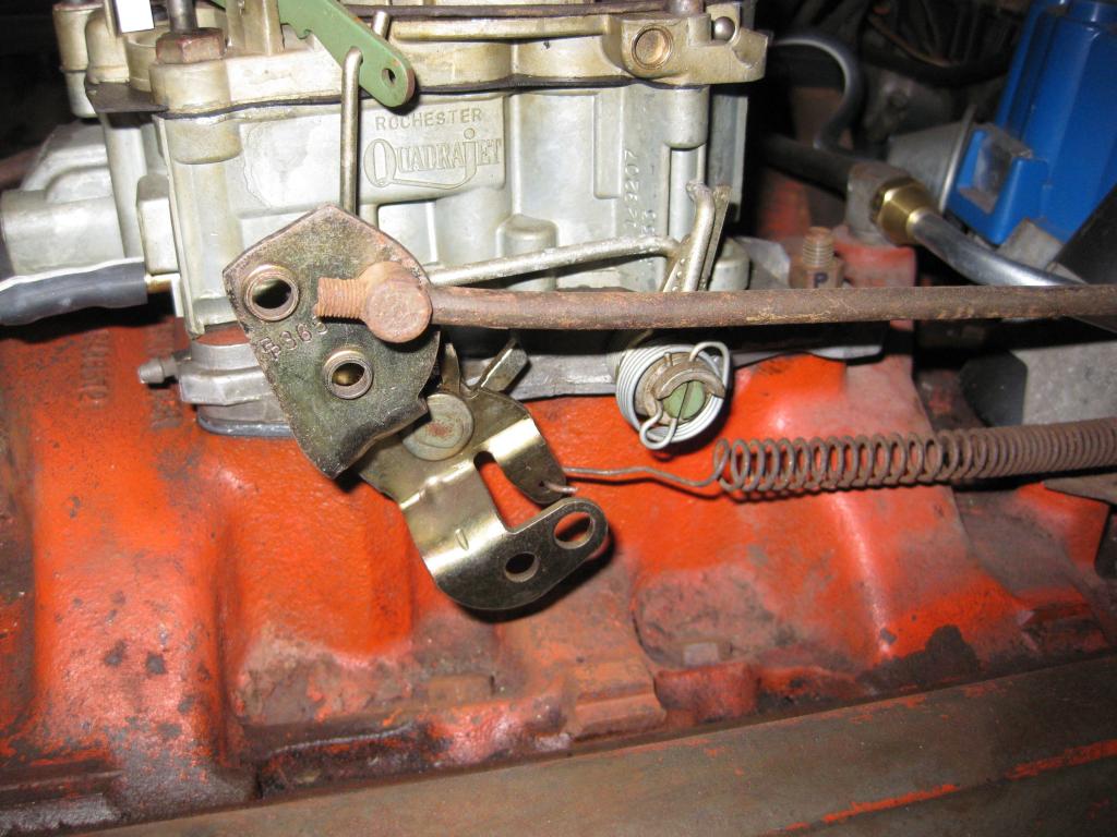

69PACE 08-17-2013 01:18 PM
Re: 1969 Camaro SS350 4spd. throttle rod
<span style="font-weight: bold">Sal - I have no reason not to believe the rod on my 69 L48 is not original but all I can say it was on her when I bought her in the early 80's.</span>
For some odd reason the picture links here are being truncated.
69PACE 08-17-2013 01:35 PM
Lets try that again - name change and lower resolution
https://www.yenko.net/ubbthreads/pics...ttlerod001.jpg
https://www.yenko.net/ubbthreads/pics...ttlerod002.jpg

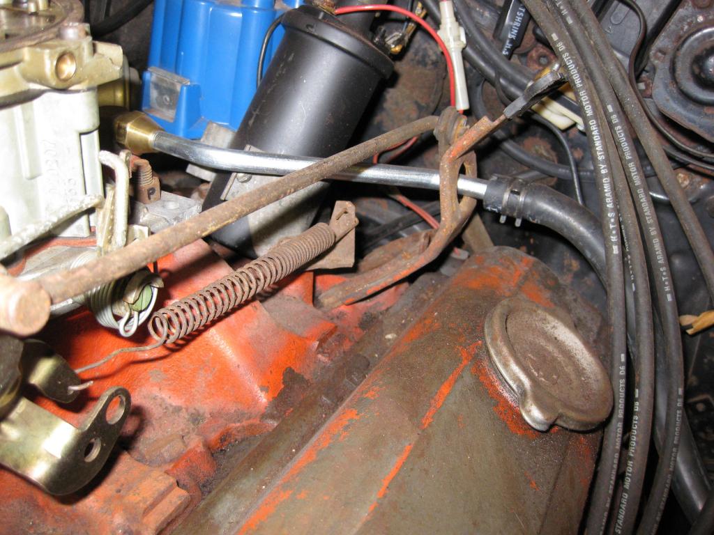

KevinW 08-17-2013 07:19 PM
Here is my throttle rod. Similar to 69Pace, but mine has more threads. I put mine on the inside of the carb linkage plate as it seemed to work better there. It was binding on the outside. The TV cable and anti deiseling soleniod mount are my design, not factory (but work really well!) [img]<<GRAEMLIN_URL>>/smile.gif[/img]
http://www.fototime.com/C74B3F75A8B8BB2/standard.jpg
http://www.fototime.com/D7A960565E5314F/standard.jpg
69VN 08-17-2013 07:52 PM
I see that you have an automatic setup which is fine. The one that 69PACE has looks to be for a manual trans. Thanks for your help guys and I'll look into it more.
KevinW 08-17-2013 07:59 PM
The engine/carb is a manual trans HA engine (correct numbers, block, heads, intake, carbs and dated) from my SS350 and that is the linkage that I will be using. The engine is temporarily in my other car (327/auto) while the original 327 is getting rebuilt. Once I get the SS restored, the correct engine will get back to where it belongs [img]<<GRAEMLIN_URL>>/smile.gif[/img] The 327 2bbl linkage looks the same as that except the rod is a little shorter due to the placement of the 2bbl is back a little bit from the Qjet.
