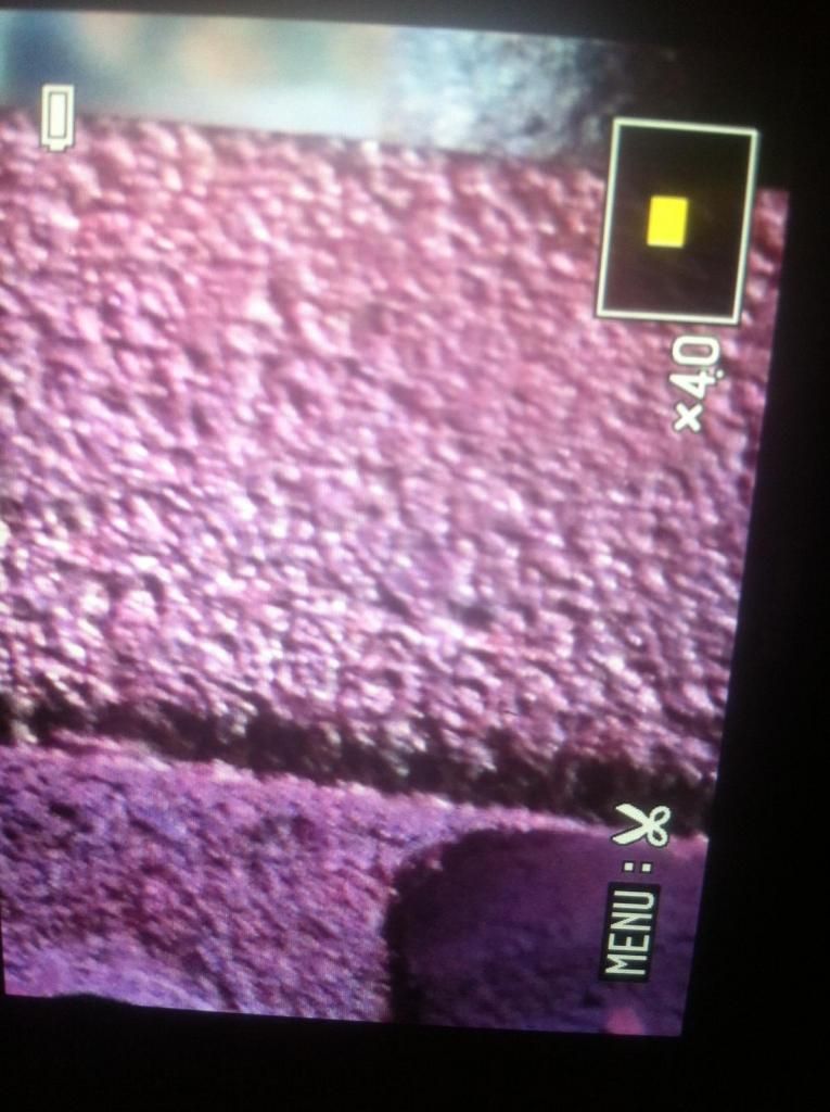

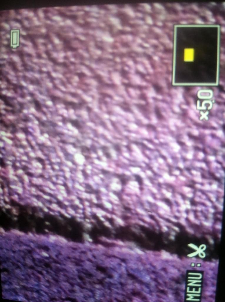

Still trying to get a VIN stamping Pete...it's there down by the oil filter, trying to get the camera to pick it up...mostly 19N? ?5650 I think. My best guess right now is 19N705650
Tracker1 10-23-2013 10:10 PM
Re: Thoughts on this DZ stamping
or 19N705565 - that end zero I am seeing may be an optical illusion
http://i962.photobucket.com/albums/a...s8c5dfc40.jpeg
http://i962.photobucket.com/albums/a...s79a16440.jpeg
Tracker1 10-23-2013 10:35 PM
added some numerals to the pics as to what I think I am looking at
