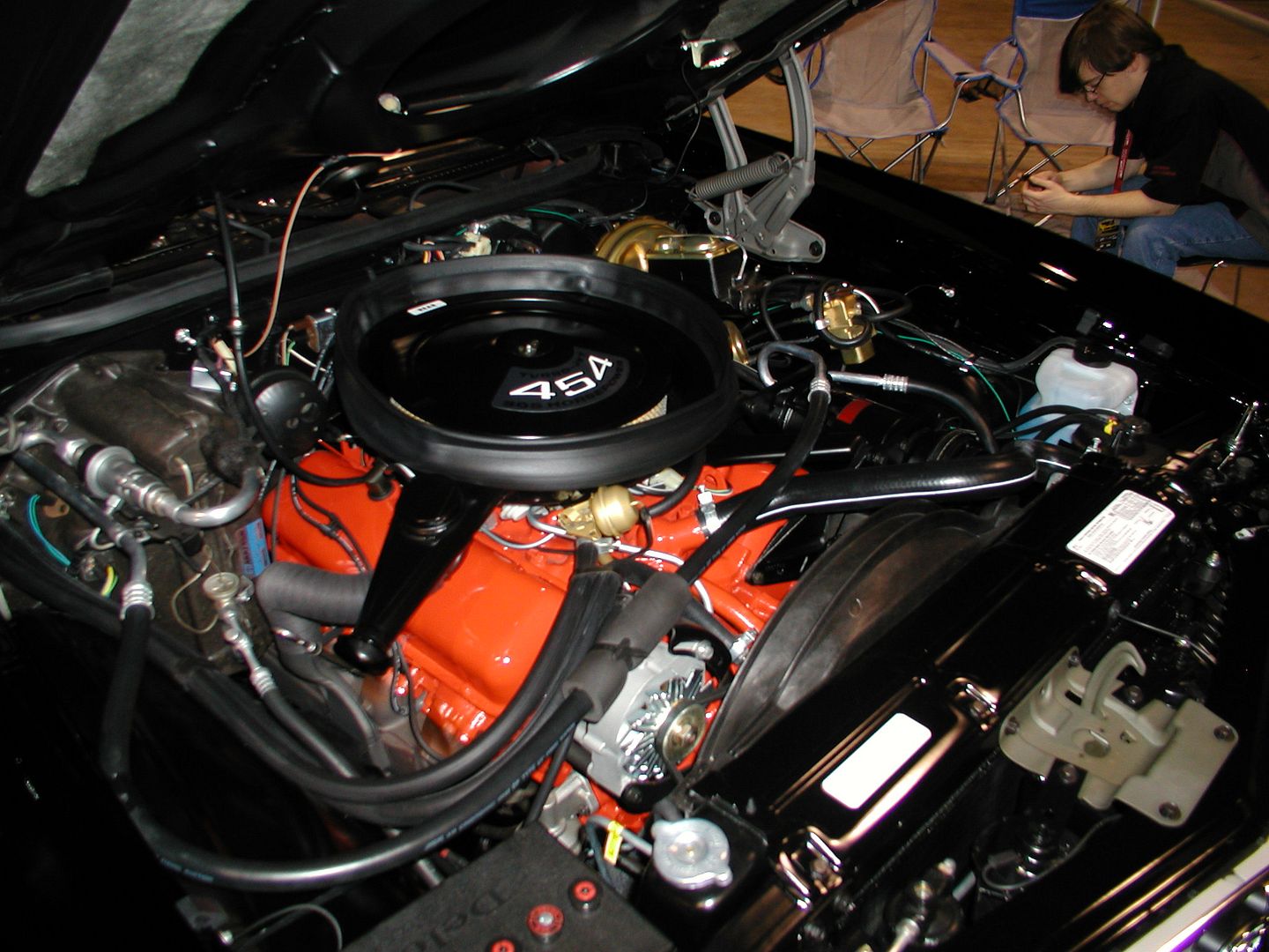

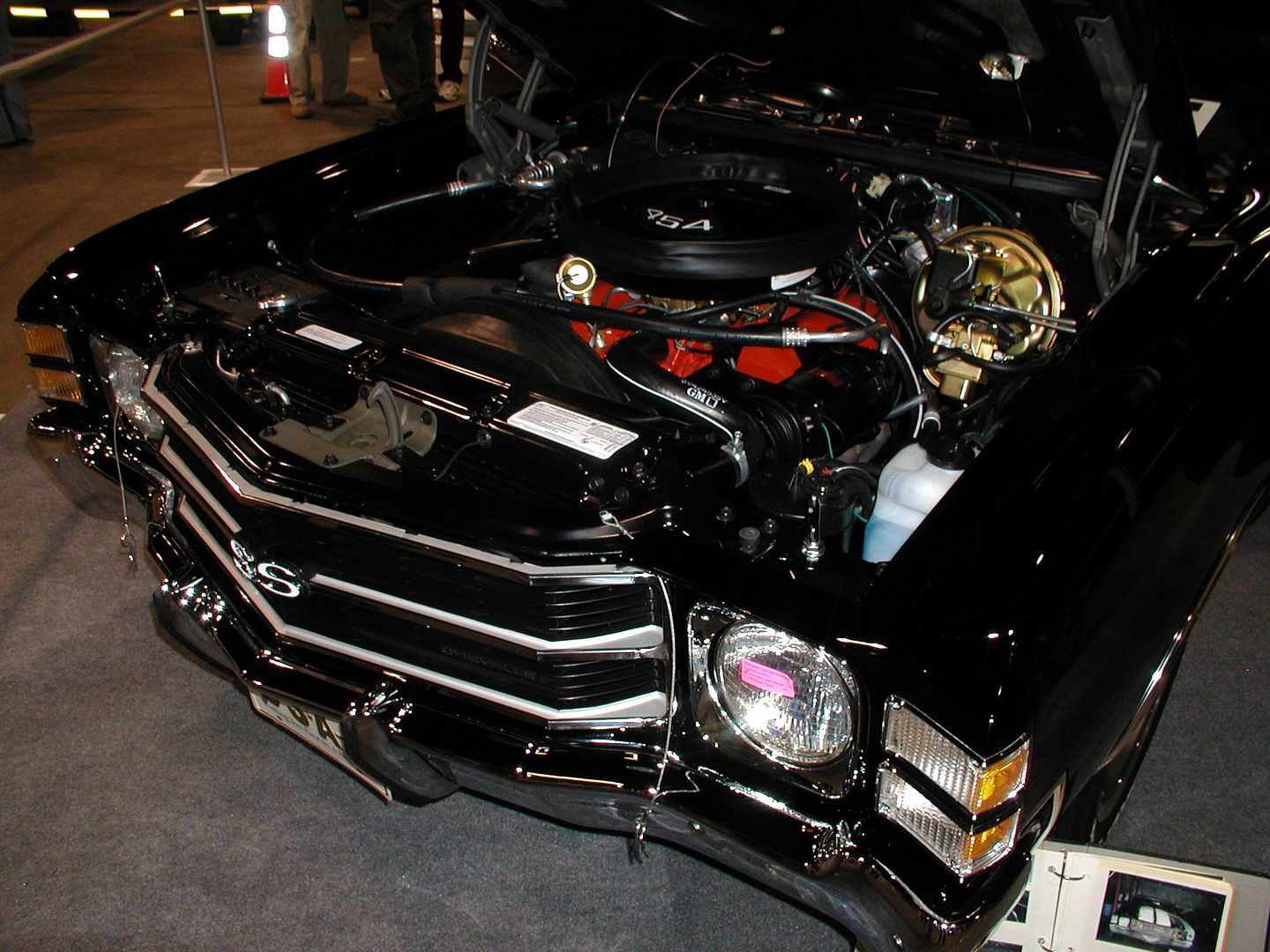

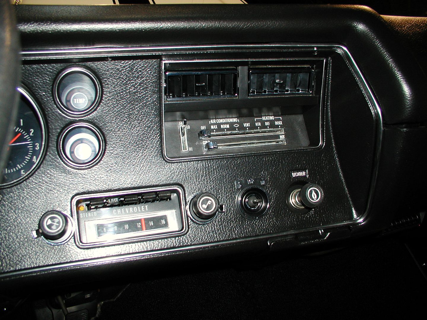

Correctly restored Chris White 1971 Chevelle [img]<<GRAEMLIN_URL>>/worship.gif[/img]
http://img.photobucket.com/albums/v6...ps2c8ce6b9.jpg
http://img.photobucket.com/albums/v6...psf242c682.jpg
http://img.photobucket.com/albums/v6...psc67a03c3.jpg
http://img.photobucket.com/albums/v6...psb8ffbf4f.jpg
http://img.photobucket.com/albums/v6...ps1cbbad26.jpg
http://img.photobucket.com/albums/v6...ps262a1b75.jpg
http://img.photobucket.com/albums/v6...psede2523d.jpg
http://img.photobucket.com/albums/v6...ps3d7410e7.jpg
http://img.photobucket.com/albums/v6...ps24232eb9.jpg
http://img.photobucket.com/albums/v6...psd12a9269.jpg
http://img.photobucket.com/albums/v6...ps060bbd95.jpg
