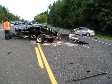

brent396 07-30-2014 11:56 AM
OUCH !!!!!!!!!
http://i411.photobucket.com/albums/p...7256718jpg.jpg

That one ain't coming back!
Mr70 07-30-2014 12:10 PM
Re: OUCH !!!!!!!!!
Geez..A new Malibu knocked that '69 Chevelle body right off the frame & twisted it.

That's a shame. The old cars are too rigid as compared to modern cars with no crushable zones that dissipate the energy over a longer time. Then the deceleration is too much for the occupant and severe injury or death results.

It's been along time since I've seen a body become detached from the frame like this, makes you wonder if aftermarket body mounts and more importantly the grade of bolts used, if this was a "frame off". Appears to have rolled to the right given the height of the "A" pillar and "sail" panel.

No semi, I think, as we would not recognize the Chevelle. But, do notice the silver car in the background of the first photo. Appears to have been a head on collision between the two. See how the more modern car is generally intact and that the front section has crushed in a predictable manner and its engine most likely went below the occupant area. Modern car designs are light years ahead of the old body over frame design and will dissipate tremendous energy and keep the deceleration time as long as possible so that the human occupants can survive (humans do not tolerate fast deceleration - think torn aortas). The rigid Chevelle in comparison imposes a much more severe (shorter) deceleration on its occupants because it is so rigid. The impact is much more jarring to the occupants. A lot of us older fellows still say we would much prefer to be in a vintage &quot;big tank&quot; vs a smaller modern car. This does not necessarily protect you.
I don't mean to get too technical or alarming, but I worked in this area (mil aviation mishaps) and there are still old wives tales circulating that could get you hurt. Don't forget to put your separate shoulder belts on too as they can make a big difference.

The obvious, as stated in the news report, is the Chevelle driver lost control being a street squirrel and was hit by the &quot;modern&quot; Malibu broadside at a high rate of speed:
&quot;Multnomah County sheriff's deputies said the witnesses saw the Chevelle begin to fishtail, make a correction, then fishtail again, entering the oncoming lane and being hit broadside by the Malibu.&quot;
I will bet the rear tires on the SS were &quot;old&quot; and offered little traction. Anyone that drives a car like this with old tires (heat cycled to death from age or burnouts) and thinks it is &quot;cool&quot; because the rear tires break loose in 2nd or even third are fooling themselves.

Looks like the velle got tagged in the left rear and then turned and rolled. Notice the rear is caved in, frame twisted and the front survived although dislodged.Ouch is right...
