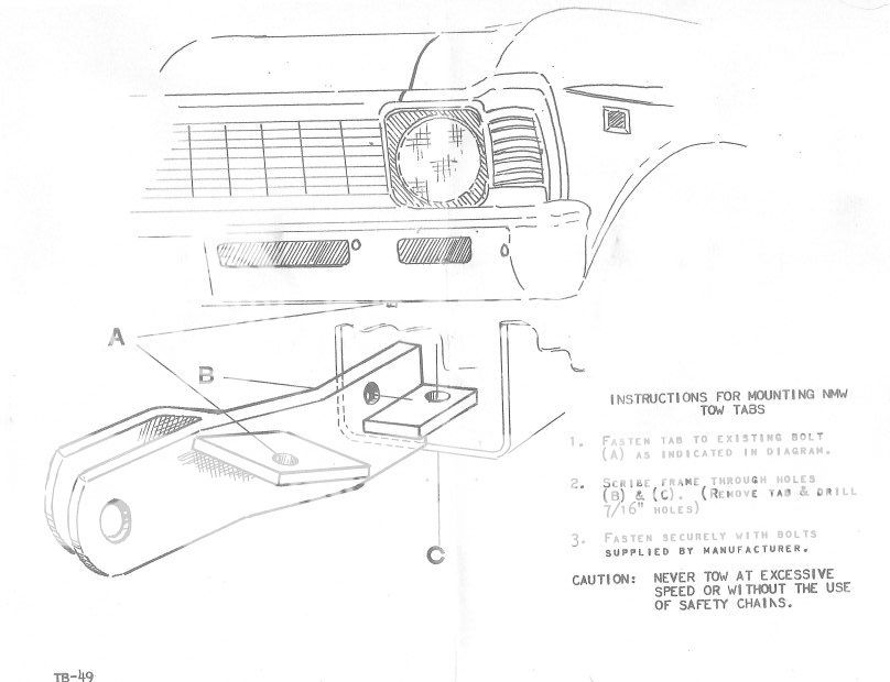

PxTx 10-26-2014 10:04 PM
Re: HELP ! tow tabs installation.
https://www.yenko.net/ubbthreads/ubbt.../topics/493755
I think there is a decent pic here. I do have the original I structions on my pc I can post them tomorrow. I've had good success bolting them up, though not everyone drills the extra holes.

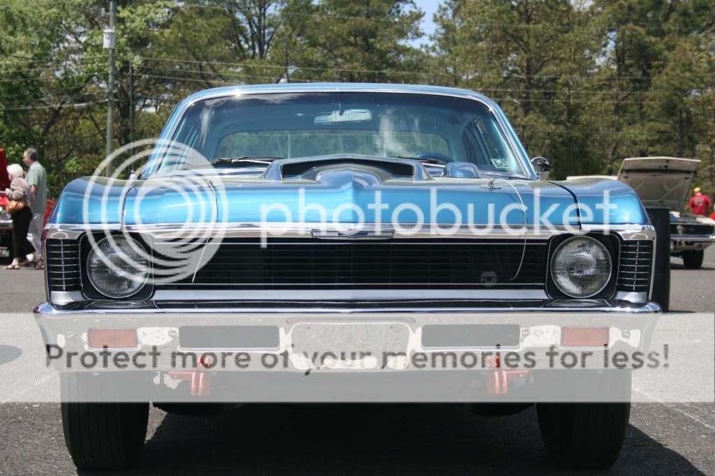

PxTx 10-26-2014 11:27 PM
http://i710.photobucket.com/albums/w...ps929ef7ec.jpg
Here is a pic I took of Jed's Nova with a set of them.

PxTx 10-27-2014 01:04 PM
http://i710.photobucket.com/albums/w...ps4242a23a.jpg
slimsls6 10-27-2014 02:46 PM
Thanks Paul. That's what I needed. Thank you for your efforts. I will get back at it in a couple days.
