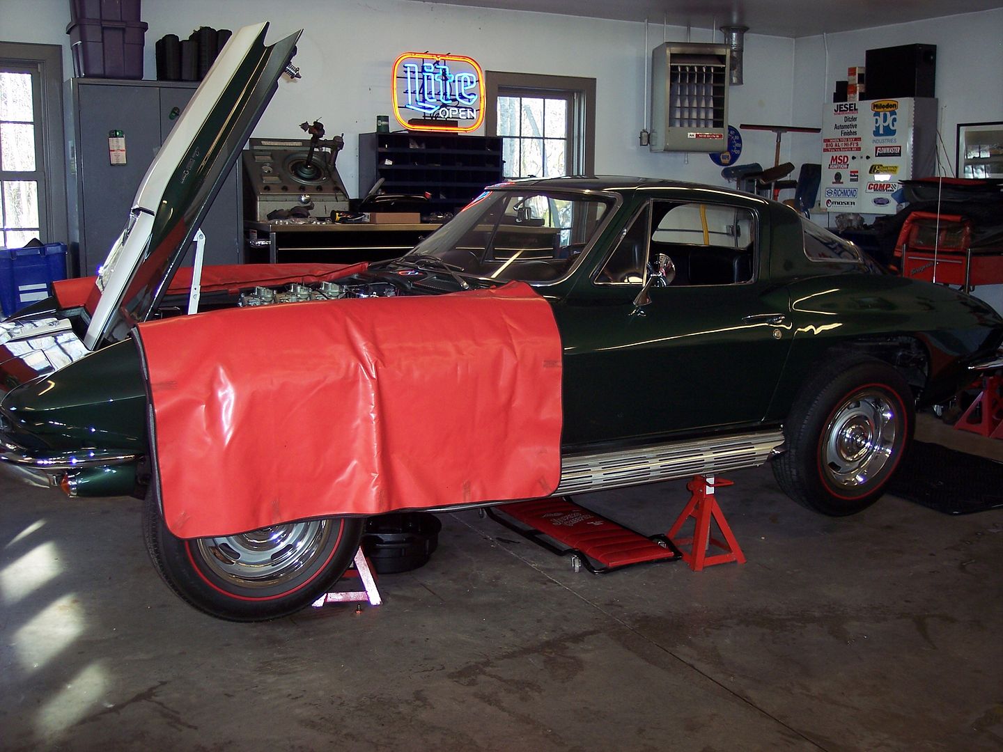

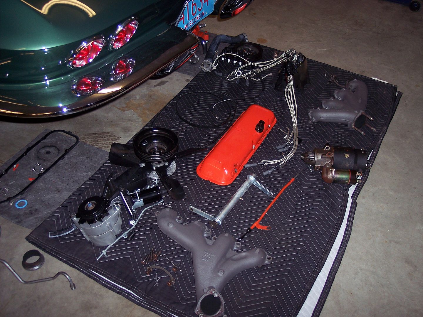

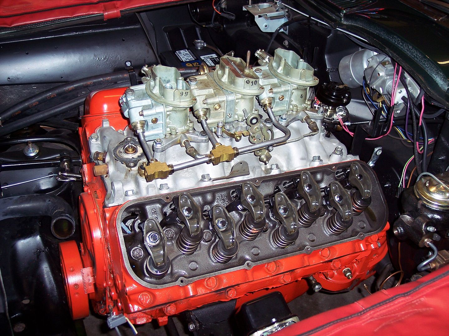

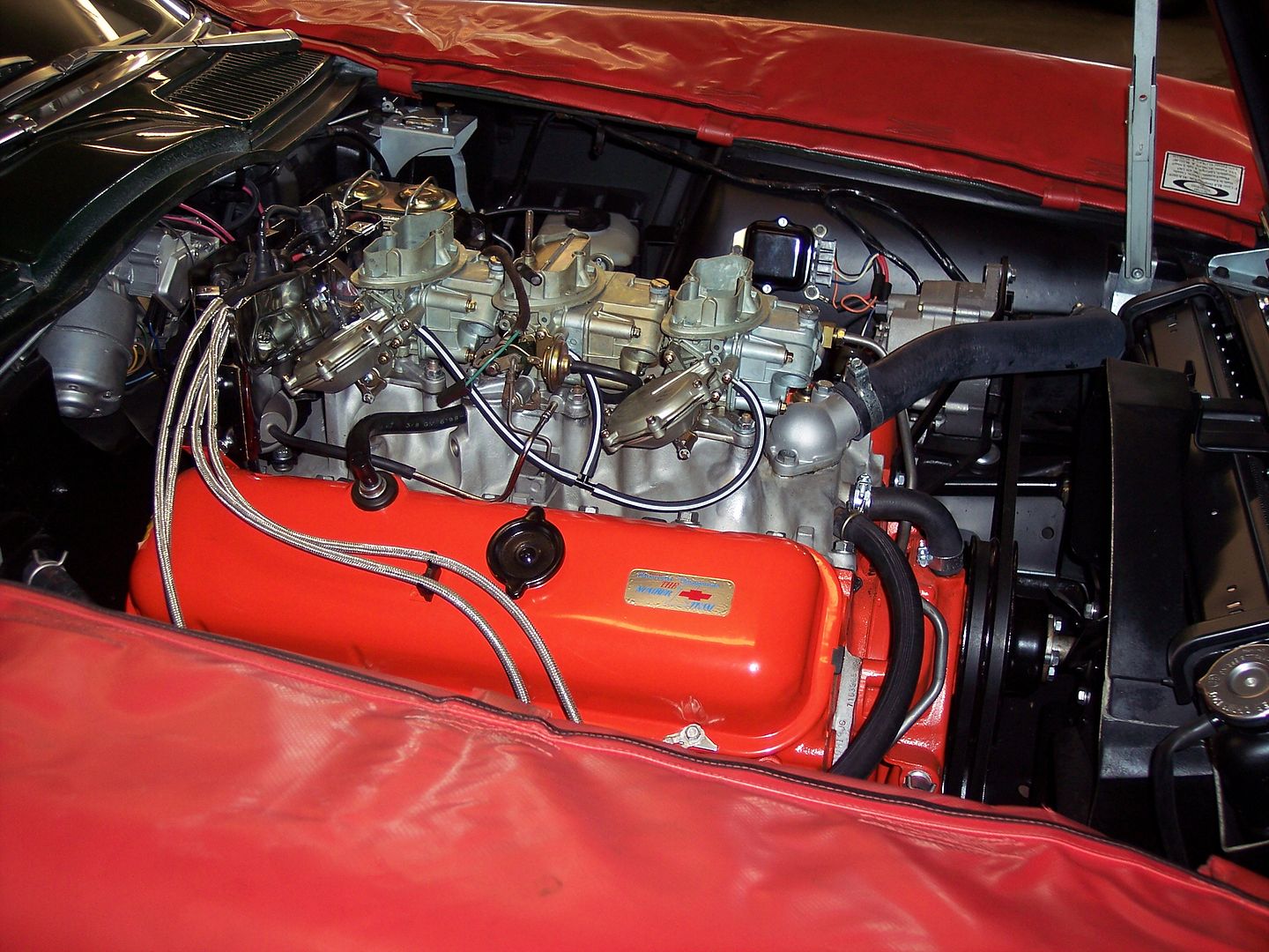

You gotta revisit what you have done already. Not even 500 miles and I have a valve train issue that shows up after 2000 rpm on the left bank. I would say I have a cam bearing issue. Out it comes! Just kind sucks.
Off to the machine shop and regroup before something gets wrecked

Hmmmm, a cam bearing noise on the Left Bank ??? Cam bearings are fixed to the bore journal ,centered on the cam ...... Both Banks would have a noise.
Doesn't sound right to me either....
You don't think its a bad Rocker Arm, pivot ball, lock nut or an issue with a Rocker arm Stud ?
A too long or too short pushrod ?
Just my thoughts. .. somewhere on the Left bank you may want to check.

Right side is a problem too. #5 more than anything. Collapses over 2000 rpm when the oil temp comes up. Go back to idle, pumps back up. Changed out all of the lifters (cam and lifters looked good), the same problem. Oil pressure is well north of 70lbs cold (idle) and is at 50lbs at a hot idle (stock pump and spring) Checked valve springs...............they were new and good. Gotta pull it apart before something gets wrecked.
