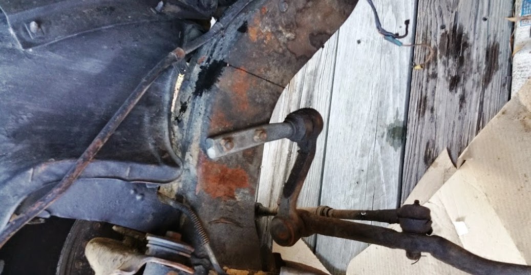

https://lh3.googleusercontent.com/-X...o/steering.jpg
https://lh5.googleusercontent.com/-H...o/steerbox.jpg

Not so much an old drag car as an old street racer car. Car is on 4 flats on a trailer, no major rust and nothing cut out of the car (ie firewall, qtrs., etc). One fender looks like it was changed somewhere in the past and one looks original. Has a 12 bolt, but I could not get far enough under the car to see the top of the axle tube to get a code, and since I thought that the 68's had the traction bar I just figured it was not the original rear. It does have the 4 leaf springs (forgot to snap a pic of that).
Nothing original as far as engine/tranny or parts such as carb, exhaust manifolds etc.
