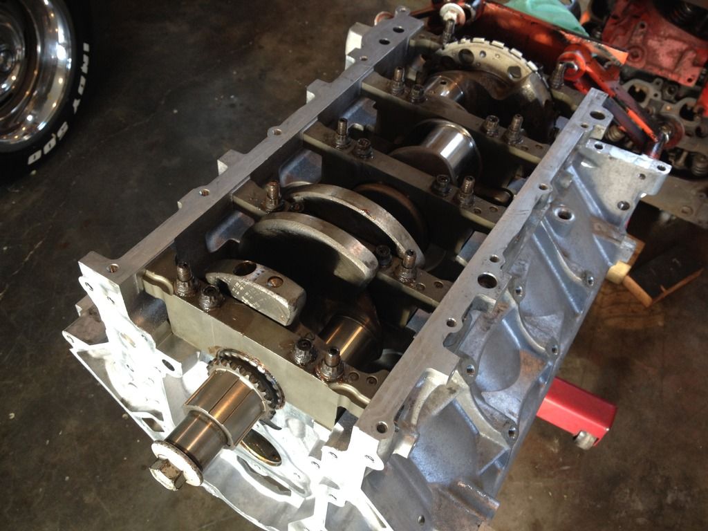

469 is out at the machine shop. Will know more about it once he makes a cleanup pass.. In the meantime, I am throwing together the LS engine. Coated the bearings and pistons today. Within the next few days Ill drop the crank in along with the pistons.
<span style="font-weight: bold">Bare block after cleaning</span>
http://img.photobucket.com/albums/v6...psm3zvxzmc.jpg
<span style="font-weight: bold">Mains coated</span>
http://img.photobucket.com/albums/v6...pshhrrhysi.jpg
http://img.photobucket.com/albums/v6...psli9mn4mc.jpg
http://img.photobucket.com/albums/v6...pseh0a1omc.jpg
<span style="font-weight: bold">Rods and pistons before</span>
http://img.photobucket.com/albums/v6...ps03bq0ltz.jpg
<span style="font-weight: bold">Rods and pistons after coatings</span>
http://img.photobucket.com/albums/v6...ps8gmbigqv.jpg
http://img.photobucket.com/albums/v6...pse3fu9sgr.jpg

I have slacked off the LS engine due to waiting on parts and the BBC is still at the machine shop.. So I finally got around and installed the crank on the LS.

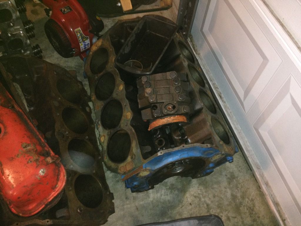

http://i614.photobucket.com/albums/t...pstio3twr3.jpg
http://i614.photobucket.com/albums/t...psfich2bdd.jpg

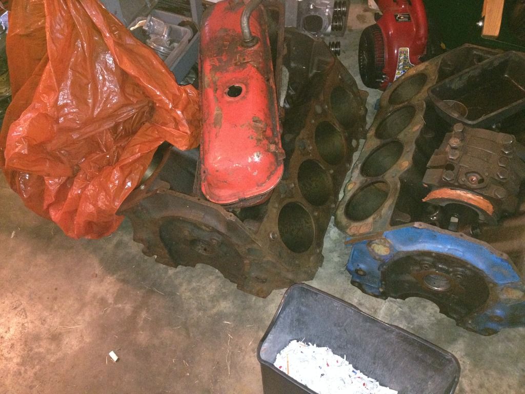

I also have a few new engines in the garage.. Along with a couple sets of heads.. Looks like Ill be alittle busy this fall &amp; winter.. [img]<<GRAEMLIN_URL>>/biggthumpup.gif[/img]
http://i614.photobucket.com/albums/t...psrvr7h6nn.jpg
http://i614.photobucket.com/albums/t...psratbdqne.jpg
http://i614.photobucket.com/albums/t...psccaqliud.jpg

Took this morning to get the LS shortblock together. After measuring the end play on the crankshaft at 0.008&quot; It was time to throw the slugs in the holes.. Because this engine is being setup for a turbo I gapped the rings at 0.026&quot;. Pistons are JE with coatings applied by yours truly, rods are Eagle with ARP rod bolts, rings are Mahle and bearings are King.. The red coating you see on the crank and rods etc is Comp Cams Valve train lube for help with the first dry startup. I also spray down anything internal if the engine will be sitting for any long period of time.
http://img.photobucket.com/albums/v6...psiatztppy.jpg
http://img.photobucket.com/albums/v6...psixwedsa4.jpg
http://img.photobucket.com/albums/v6...ps6zjcdxcf.jpg
http://img.photobucket.com/albums/v6...pscmdjtvzf.jpg
http://img.photobucket.com/albums/v6...pscfru0zly.jpg
