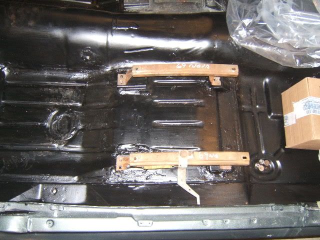

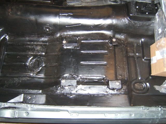

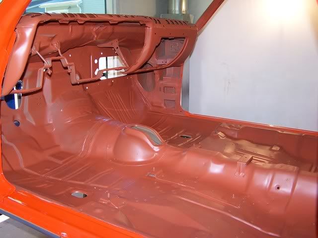

I'm also looking for a nice clear picture of a 69-72 Nova floor pan from inside the car, with the carpet removed so I can see the placement of the bucket seat brackets welded to the floor. I have the brackets, but the 2 pictures I have aren't clear enough to see the bracket details.

I do have those pics on file Steve. They aren't clear enough to see where the small outside seat brackets go. I thought someone might have a good pic of a clean bare floor that would show it more clearly.

Still looking for a pic of a clean/blasted/painted floor. Just not sure where the 4 small seat track brackets go. I have most of the parts to do this conversion. I'm still driving the car. As soon as the snow starts flying, I'm planning to do this project. I guarantee it will come out the way I want it to look, otherwise, I wouldn't do it, or spend the couple thousand dollars in parts.

I'm looking for a Nova floor pic like this one I have of my El Camino floor. Anybody?

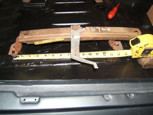

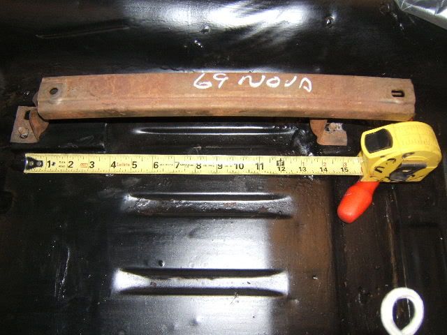

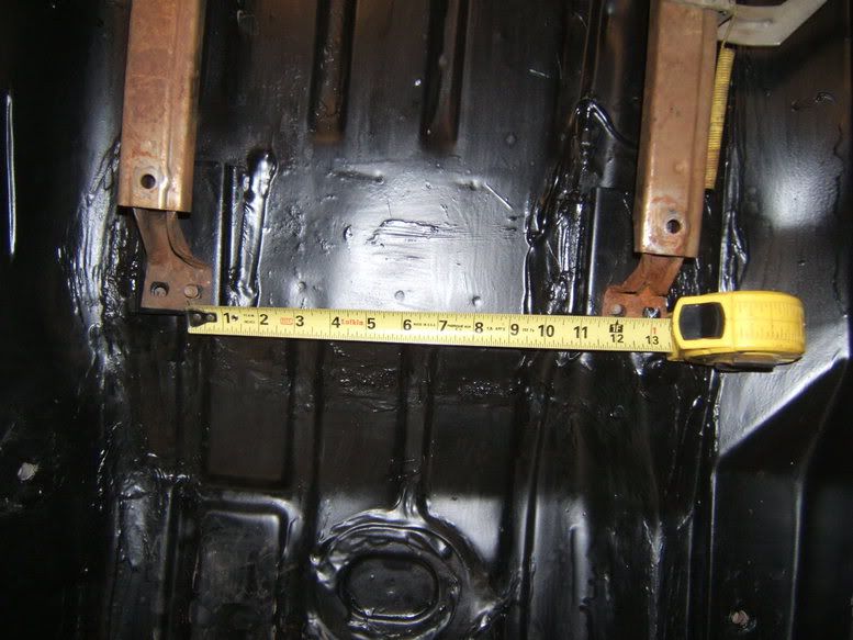

Bill having a nova with bucket seats IMHO isn't going to make you back issue any better. This is one of the main reasons I sold my 68 L78 nova with bucket seats. I was very uncomfortable driving the car. Not enough leg room for me and if I was in the car driving for a short period of time I could barely walk when I got out. The nova seats sit up high for me being 6'3 my head and leg room was limited. But I think this is what you are looking for? You know 68-71 nova bucket seat brackets are nova only, chevelle bucket seat tracks are longer.
http://i35.photobucket.com/albums/d1...130_190354.jpg
http://i35.photobucket.com/albums/d1...130_171320.jpg
http://i35.photobucket.com/albums/d1...130_171244.jpg
http://i35.photobucket.com/albums/d1...130_171106.jpg
http://i35.photobucket.com/albums/d1...130_171015.jpg
