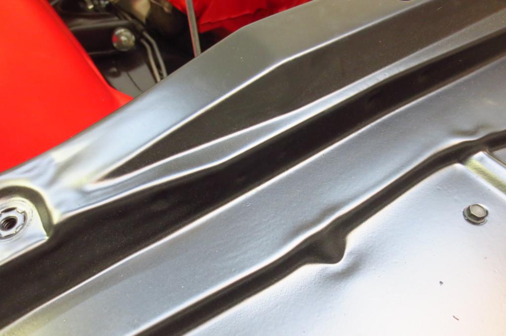

Jim Ferron 12-09-2015 05:33 PM
Re: undercarriage semi gloss black
I've been using SEM Rust Shield in 'black' thin no more than 10% ...dries down nice. Tad flatter than the Concept. I used to use PPG with 'flatner' in years gone by but found the 'flatting' agent to be wildly inconsistent from job to job.

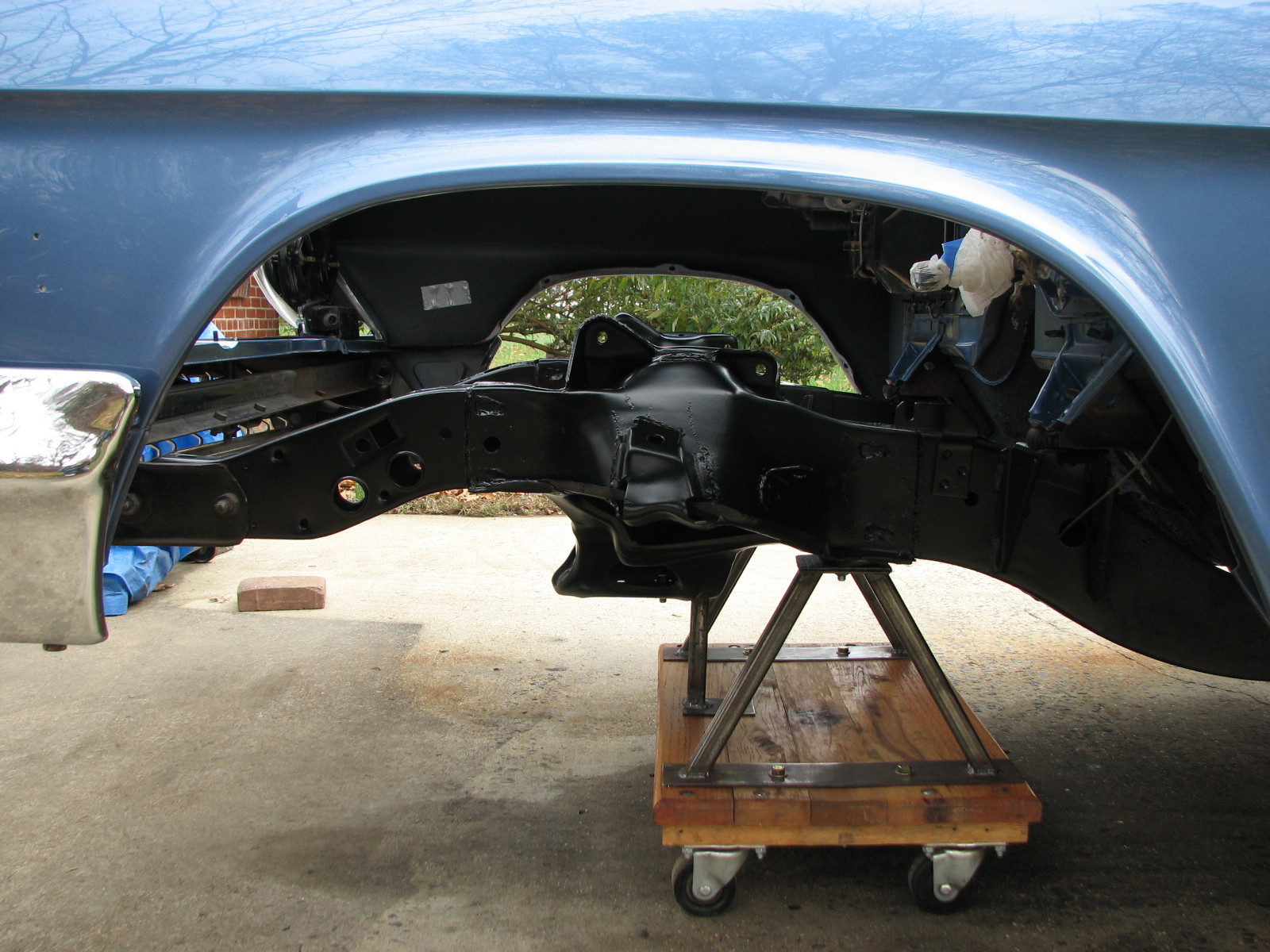

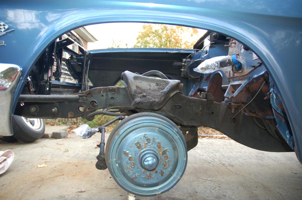

Verne_Frantz 12-09-2015 07:04 PM
<div class="ubbcode-block"><div class="ubbcode-header">Originally Posted By: 1968 nova ss</div><div class="ubbcode-body">Guys, lookin for some help in painting the undercarriage and firewall on my other 68 nova ss in the black semi gloss look, some like it a bit flatter ,but a prefer a little shiny look... lookin for a mixing formula to achieve this look..currently the underneath is in a PPG DP 90.. it is ready to spray and would like to make sure I get it close...any help appreciated...PM me if would prefer to sent a mixing formula ,would prefer a PPG mix as this is a PPG store here in florida locally... thanks,Chris Teed </div></div>
The DP 90 you already have on there is probably the &quot;by the book&quot; mix of the DP and hardener, so it's probably a little dull. I had an experienced painter advise me to add some reducer to give it some gloss (just a little). DP hardens like a rock and seals the surface so I decided to leave it that way, without a top coat of paint. I practiced a lot on some scrap metal and wound up with (what I think) is the perfect finish. I shot it wet with a lower pressure than recommended. Like others have said, you just have to play with the reducer and your gun settings and spray test patches until you're happy.
Before
https://www.yenko.net/ubbthreads/pics...6-dsc_0878.jpg
After
https://www.yenko.net/ubbthreads/pics...wraped_003.jpg
Verne
