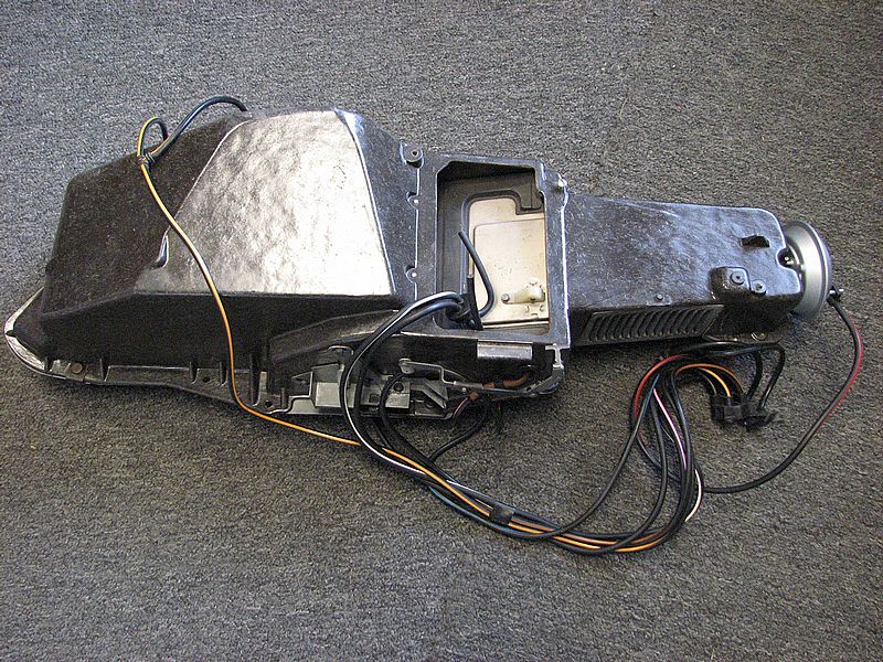

Here are some photos of the AC box.

The rear part of the passenger side and the top has lost the shiny gel coat finish and the bracket for the POA valve has lost the phosphate finish. The bracket below the POA valve bracket used for the expansion valve is in very nice condition. The driver side of the box is not bad.
Should I try a new application of gel coat or just refinish with clear either directly or after a light media blast? Any specific suggestions for a brand of gel coat? Will I need to clear coat with a spray gun or could I use a spray can product? Any specific suggestions for products?

olredalert 02-21-2016 02:42 PM
Re: Refinish AC undressed fibreglass cover
----Maybe its just me but what you have pictured isn't bad enough to gel-coat. Clear it!.....Bill S
