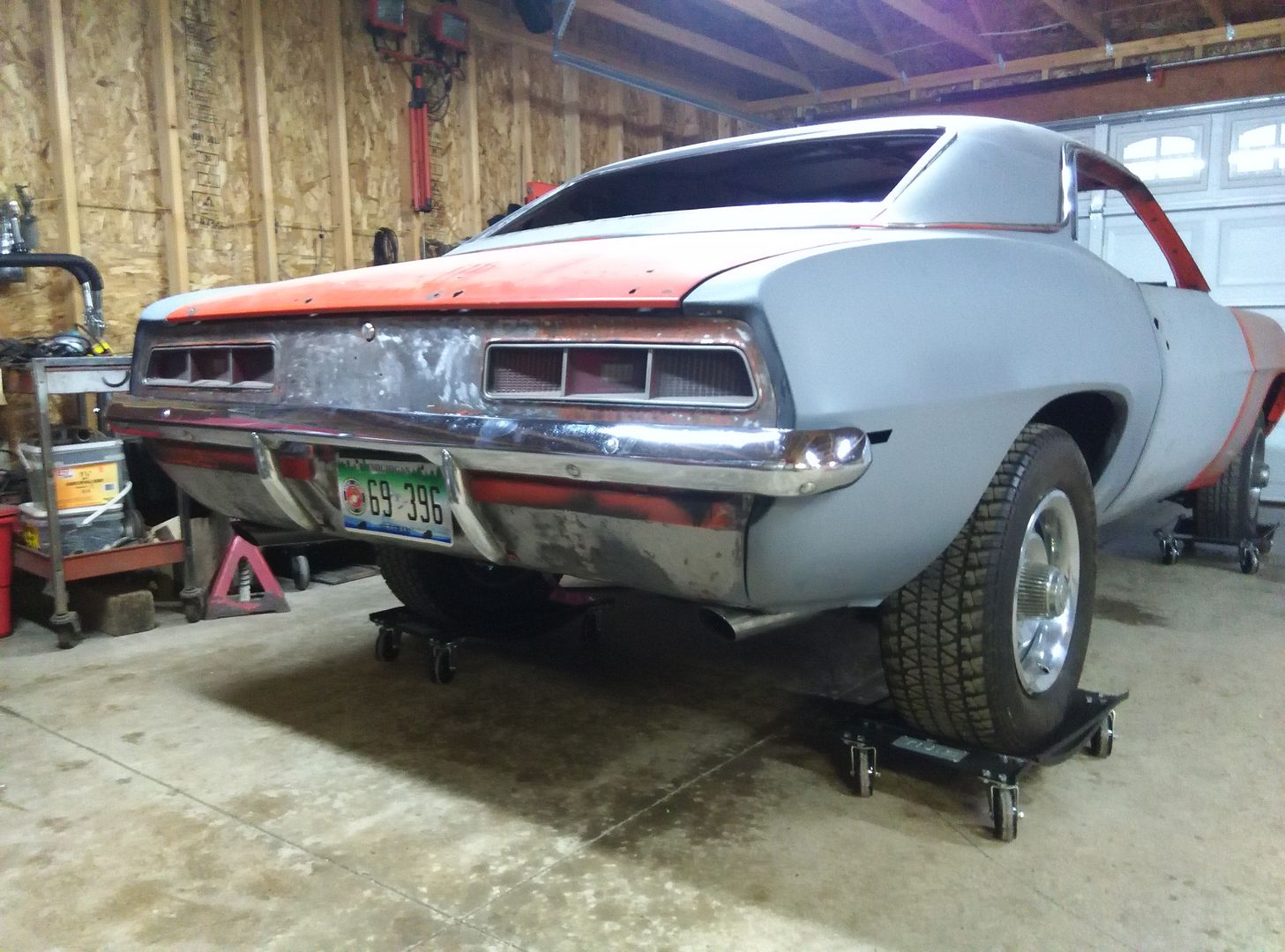

69 Camaro custom shock height
My 69 sits a little higher than most 69s. I like it that way and I want to use regular shocks, not air shocks. I've been looking around, but I'm having trouble finding something that will fit or finding a way to search for certain heights.
It currently sits right at 19 3/4" shock length at rest. I figured about 12"-13" compressed and, what, 23" extended?
Any suggestions on how I can track down a shock? I don't want to use extenders either.
Thanks.
Currently no shocks installed in the rear. Yes, I tightened the shackles etc. with it on the ground.
http://i1164.photobucket.com/albums/...024_182700.jpg

Seems like the Napa around here has gone the way of Autozone. &quot;Let's go to the computer.&quot; &quot;Is that SS396 a V8 or a V6?&quot; lol... I might give one of the bigger shock companies a call and see what their thoughts are. Here's a couple of pics of how the shackles currently sit. My guess is the springs might even be slightly longer than stock specs to make up for the higher arch. Just a guess though. The first pic looks like the spring is scuffing the frame rail, but that was just from the install.
http://i1164.photobucket.com/albums/...405_071444.jpg
http://i1164.photobucket.com/albums/...405_071430.jpg
