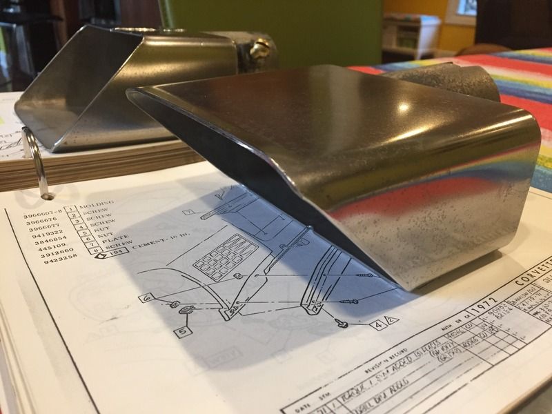

Whats everyone using to clean flash chrome? These are my original exhaust tips off my Vette.

very thin layer of chrome. if it is stainless I would have those exhaust tips polished. Maybe try some Mothers or Wenol (red tube) all purpose metal polish.

I clean a lot of chrome parts. Soapy water and 000 steel wool works well. I generally use 000 steel wool and Windex.

Darren, I'd clay them with soap first. Then take 0000 steel wool with Blue Magic metal polish. Will clean up perfectly. I did the same process on the original tips off my '70 LT1.

DarrenX33 07-20-2017 03:21 AM
Looking better

Clay and soapy water then chrome polish with 0000 steel wool for the outside. Then easy off oven cleaner for the inside.
