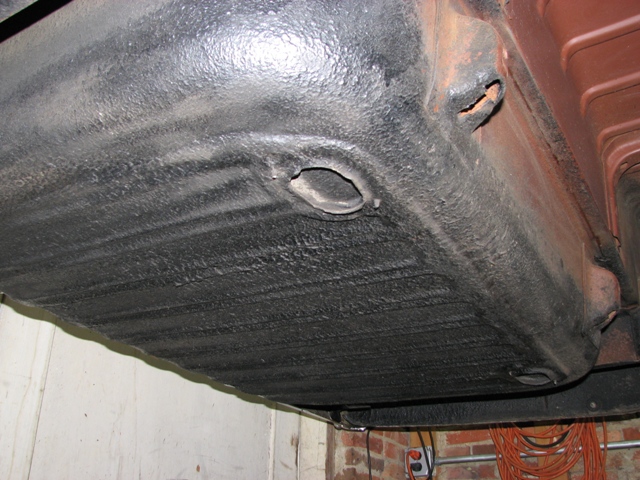

Verne_Frantz 07-19-2017 04:48 PM
1 Attachment(s)
Originally Posted by firstgenaddict (Post 1360752)
Vern I have used asphalt based roof patching material. Comes in a one gallon size at Lowes or Home Depot.
That sounds like it's worth a try. This is what I'm trying to duplicate. The dealer really shot everything in site with this stuff.
Verne
Attachment 97029
