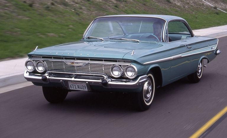

Verne_Frantz 10-05-2017 07:51 PM
1 Attachment(s)
Twilight Turquoise with Dale driving in '95
Attachment 101154
SuperNovaSS 10-05-2017 08:34 PM
It even still has the same plate. Well done bringing this to light Verne.

luzl78 10-05-2017 11:40 PM
Attachment 101154
I can't stop looking at this car...absolutely love this car and especially the color.

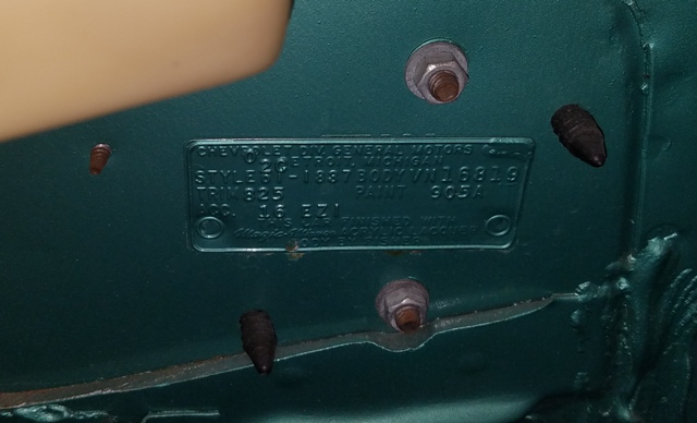

Verne_Frantz 10-06-2017 03:30 PM
2 Attachment(s)
Maybe "pulling it" would be too strong of a reaction. When I told the auction person about the issue with the cowl tag, he said he'd look into it and if need be, revise the description of the car. They could have stated that there had been a color change and the tag was modified to reflect that, but nothing was said. Afterall, who the hell am I? I'm just some jerk who called in from nowhere with a story. He never bothered to call me back (as promised0 to let me know what they had discovered.
Here's the tracing of the tag that Dale sent to me before he restored the car.
Attachment 101164
Here's the tag on the car now
Attachment 101165
Verne
