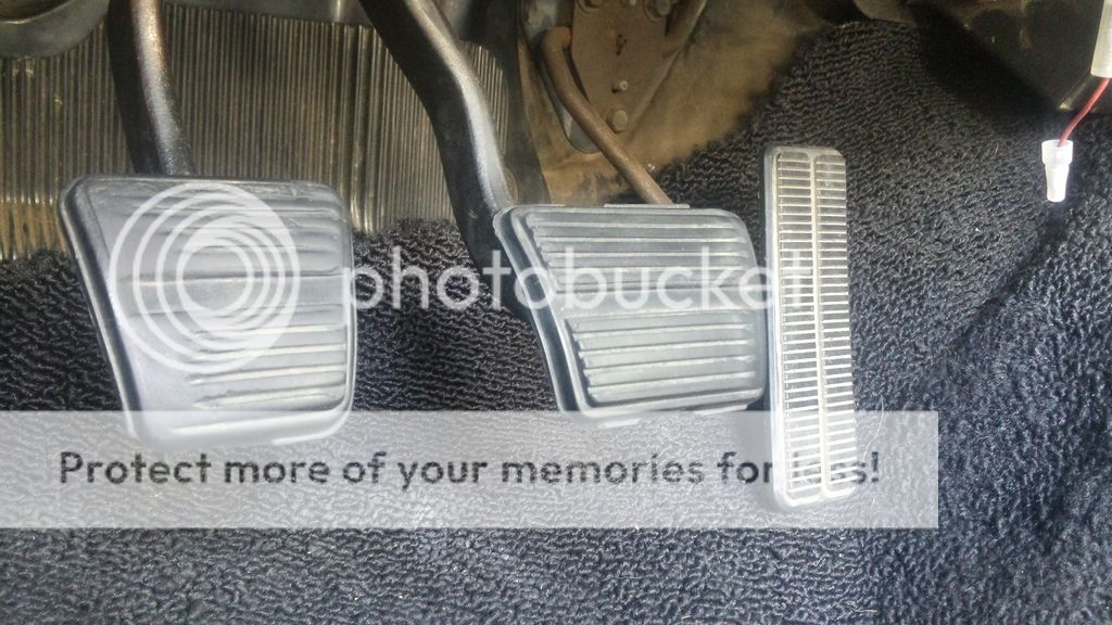

Z28 gas pedal:
http://my1970z28.com/COPO/images/DSC00547.JPG
All other Camaros:
http://i829.photobucket.com/albums/z...psatzva2fn.jpg
/Rich

442w30 10-15-2018 01:29 AM
What's the deal with the pedal? Why?
ronzz572 10-15-2018 01:38 AM
I believe it was for racing the car on the scca tracks as the z28 was designed for. heel and toe braking and acceleration.
