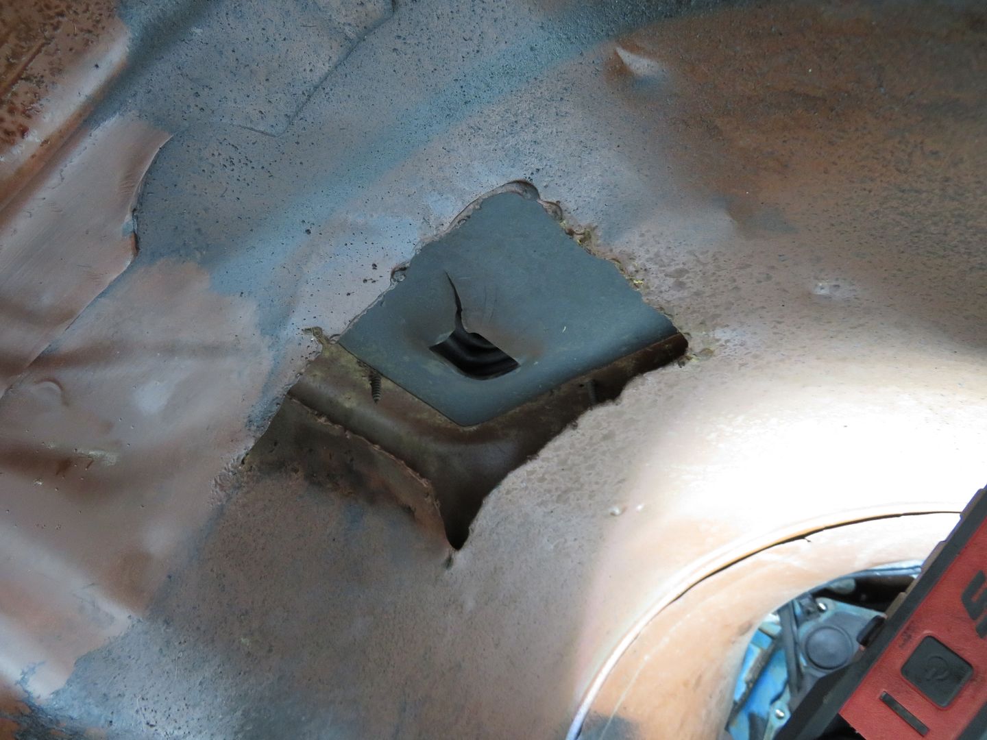

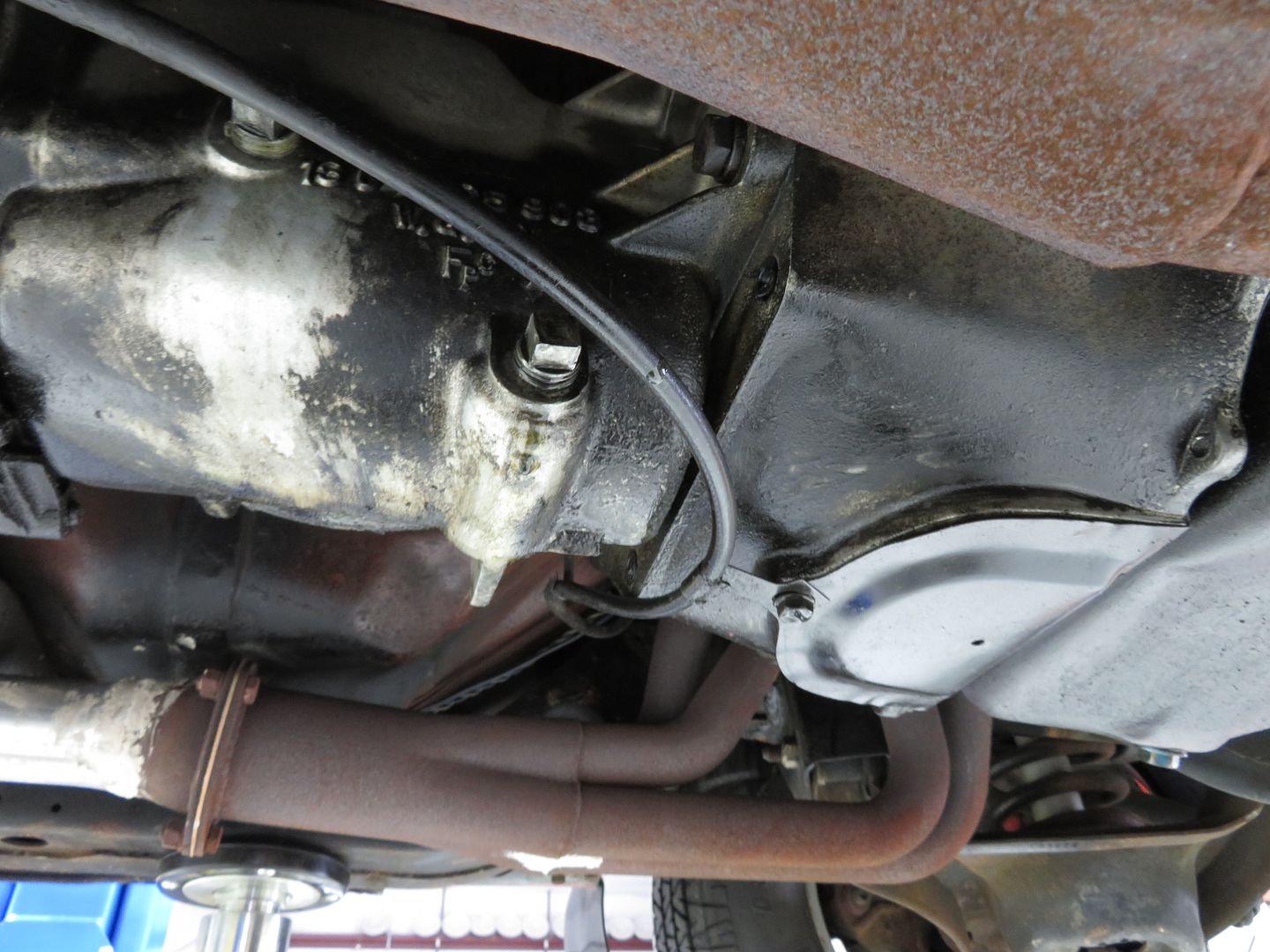

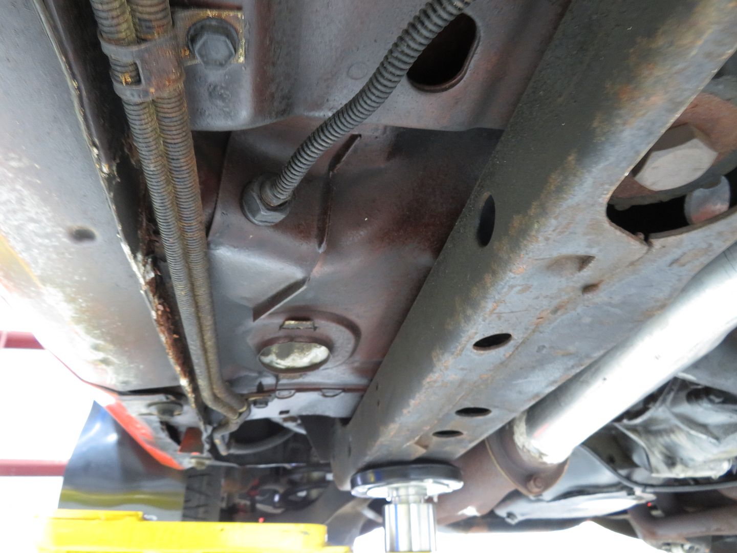

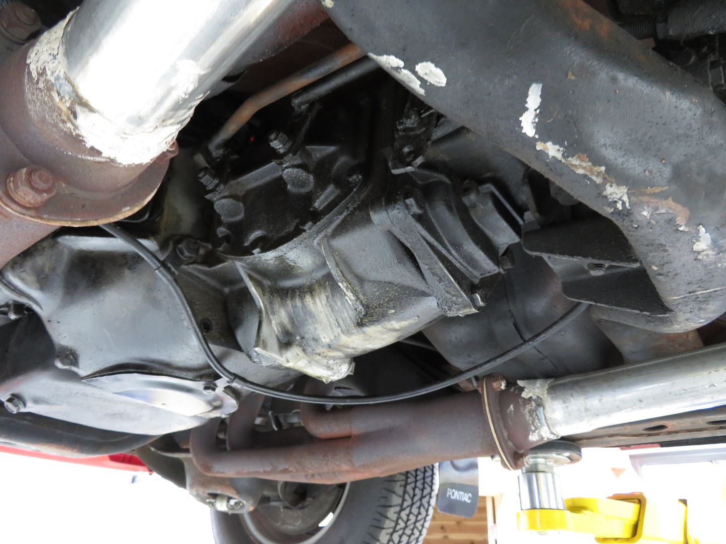

I have been working on Trans Am most of today. Here is what an hour of rubbing with rags and lacquer thinner has yielded. Any other suggestions for the cracks, crevices, brake lines, etc?
Like many cars, this thing was Ziebart coated when new.
https://i1043.photobucket.com/albums...psrzjwrhh7.jpg
https://i1043.photobucket.com/albums...psfrkn2b5q.jpg
olredalert 08-28-2019 12:27 AM
----Just me but I don't think I would use lacquer thinner. Try some thing like wax and grease remover, or just kerosene. Eventually the L-thinner will eat thru that beautiful primer, and it really does appear beautiful. Also, use plastic scrapers (you may already be doing this).....Bill S
njsteve 08-29-2019 12:05 AM
A diesel fuel-soaked rag works great. I used it to clean the bottom of our 73 SD455.
ScottG 08-29-2019 01:16 AM
I buy a gallon metal container of WD-40 and the plastic spray bottle that is made for it. Get a soft plastic bristle brush . Spray the WD-40 and let it sit a few minutes , spray it again and use the plastic brush. Keep the brush clean by washing it out with the WD-40 . It will take a while to get all the undercoating off but this will not harm any paint or primer. Any paint daubs or stencils will not go away. Get some plastic scrapers that are not sharp and those will help with the thick crap.. 5 gallons used on my 1970 GS , but it got Archival Elite at BCA Nats.. Some things are worth the effort..lol..

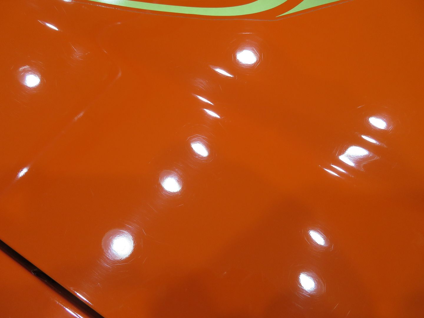

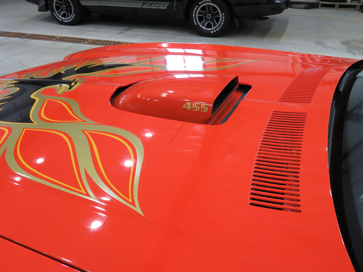

This is the result of the #7 rub down. This is strictly 3 coats of #7, no machine work. Personally, I like to avoid the machine work when I can...........
https://i1043.photobucket.com/albums...psqlu867zi.jpg
https://i1043.photobucket.com/albums...psm11bim9y.jpg
Crush 08-29-2019 12:48 PM
Well done! Did you let it soak? I did on my 75fj and it worked really well. Did you clay bar?
napa68 08-29-2019 01:18 PM
I soaked overnight and yes I clayed it out as well. I need to try one of those Eagle One mitts
Mr70 08-29-2019 01:29 PM
Eagle One Mitts are great,you'll never clay bar again.
RPOLS3 08-29-2019 02:11 PM
x1000
