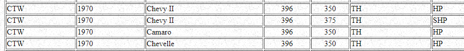

Lee Stewart 11-11-2020 04:09 PM
This help?
https://i.postimg.cc/cLfcC8QB/screenshot-8337.png
https://nastyz28.com/gm-chevy-codes/...-suffix-13.php

No, but thanks. I knew a CTW could be from a Nova, Camaro or Chevelle. Its also a 2 bolt block, so not a 375. (sorry!)
