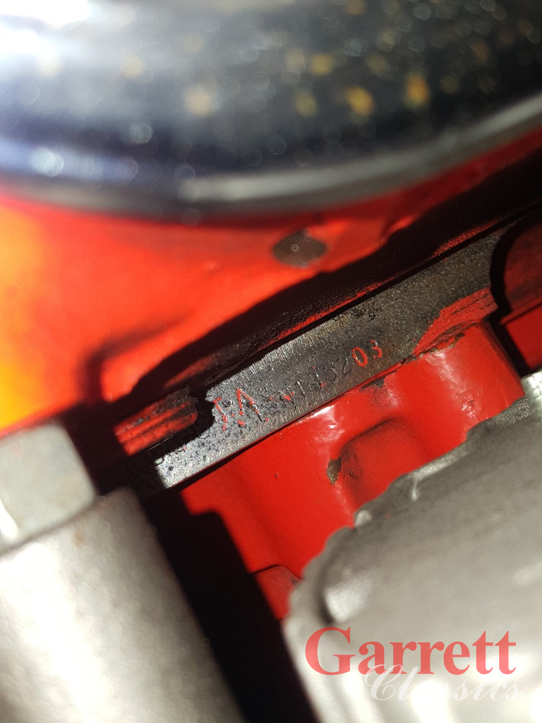

Must be a pretty rare car with the Norwood strike happening in '72. Engine stamp looks pretty good but it would be nice to see a better resolution picture.

wayoutz 10-09-2021 12:15 PM
that engine stamp looks awful
THNDER 10-11-2021 03:33 PM
Engine stamp looks legit.
Charlierogers 10-11-2021 05:10 PM
so is this stamp good or bad?
scuncio 10-11-2021 08:18 PM
I asked for a better picture. The spacing of the suffix code is tough to see, and the broach marks aren't clear enough.
olredalert 10-11-2021 09:09 PM
----Scratches on the water pump side are definetly wonky!....Bill S
Jonesy 10-12-2021 03:55 PM
I think a way better pic is needed to determine anything about that stamping.
A complete pic of the pad would help a lot.
