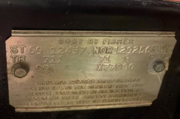

124379N561607
N561607 was final assembled on or about December 16, 1968. Has an 09C body tag 3rd week September 1969. That and the hex head screws used to fasten the tag tell me the tag is not original to the car.
Xplantdad 10-06-2022 07:25 PM
1 Attachment(s)
Wow...
Attachment 226004
MosportGreen66 10-06-2022 08:07 PM
Looks like the tag was torqued with an impact driver! And shame on BAT for continually calling these made up cars by model names they clearly did not start life as.
