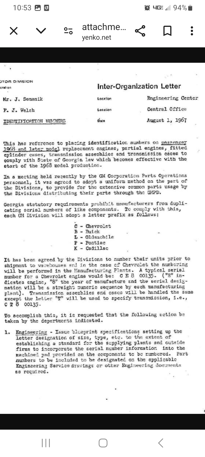

Jimlt4383 07-22-2024 03:01 AM
CE and CT definitions and started because of a Georgia law
1 Attachment(s)
CE stamp definition
McCune 07-22-2024 03:26 AM
So CE just means Chevrolet Engine. Cool.
Mr70 07-22-2024 12:23 PM
And CT means Chevrolet Transmission.
Neither stood for Counter.
1967Z28 07-22-2024 01:41 PM
CC has also been seen on Muncie cases which means Chevrolet Case. You could buy a replacement case only rather than a whole transmission through the parts department. I'm assuming the same thing for the Saginaw trannys but I haven't personally observed any.
JRSully 07-22-2024 02:47 PM
So much for the CE "Counter Exchange" theory. Thx for the info
Igosplut 07-23-2024 11:46 AM
In the 70s I was told it was counter exchange, then heard Chevrolet engine from Al Maynard.
Kurt S 07-23-2024 04:23 PM
This info has been out there since day 1 in the service information. I believe I posted the interoffice memo previously.
Quoting from the Chevrolet Dealer Service Information Bulletin, 69-I-1, dated 19 Sept, 1968:
http://www.camaros.org/engine.shtml#service
