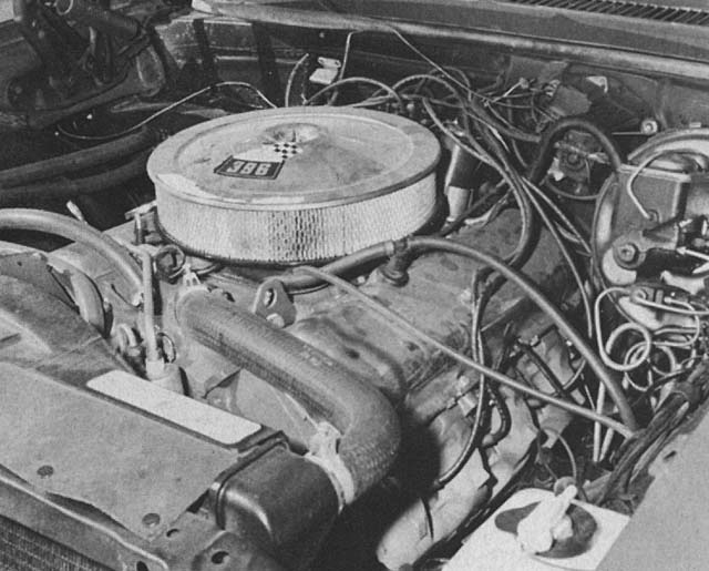

I don't know the answer for sure. I do know that some of them did get the twin lines. I have a road test here for a 1970 L34 Nova, (Super stock, June 1970) and it clearly shows the vapor return on the fuel filter. Look here I also have another road test for a 70 L34 Nova, (Road Test July 1970) and it looks like the vapor return is there, but very hard to see. Remembering that the Camaro and the Nova used the same engine assemblies, I checked an L34 Camaro article (Road Test August 1970) and the return line is clearly shown. The color ad drawing for the 70 Camaro shows the vapor return line as well. But I don't think thatyou can ever tell 100% about this kind of thing. Lots of funny stuff happened on the assembly line.

Thanks for the information. I actually have an original copy of that article in the original magazine (a big thank you to Marlin! I really appreciate it.)
The engine picture in the article shows a little more of the core support, and that particular car also has the charcoal vapor canister that was a CA emissions equipment. I know of a gentleman restoring a CA '70 SS396 L78 car who has been hunting high and low for one of those canistors (it has four "nipples" on it).
Could it be that the California smog cars only got that dual fuel line and equipment in '70? It's hard to tell what changes on these cars over 30+ years, so it's hard telling about mine. It appears to have a large diameter fuel line, but also just one under there. Oh well.... there just aren't that many '70 L34 Novas around to compare to. Maybe more than '70 Yenko Deuces, but not a huge amount more...
