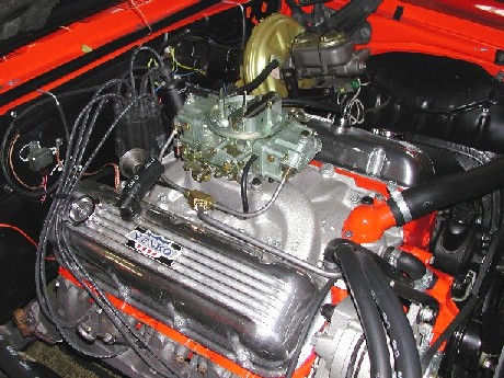

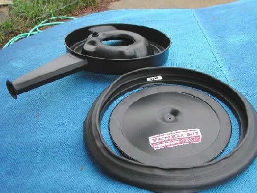

Yes it was behind a fenced off area where the cars are stored until they are picked up. The auction company is going to pay for the missing parts. Just a shame these things happen. So, he wants to replace it before they forget about it. Here are a few pictures.

Bandit, If the air cleaner in your pics was what was stolen, then it is OK. Based on what I can see from the pics, it was a repro. You can see the pics I took here to spot an original vs a repro.
http://www.camaros.net/forum/ZL2 comparison
Mr70 10-30-2004 07:02 PM
Re: Yenko Air Cleaner Asm stolen...help please.
A lot of good information on that thread. https://www.yenko.net/ubbthreads/imag...iggthumpup.gif
Just to add from what I've seen,the original ZL-2 Air cleaners have a small notch cut out on the right hand snorkle seam.It comes into play in the center of the seam.
It's about a 5/8 inch long,& 1/16th deep.The repro is one continuos seam.
Also I don't know if your Camaro thread meant this,but I have not seen a difference between a 1970 Chevelle Manual trans ZL-2 air cleaner,& an Auto trans.
Good thread!
