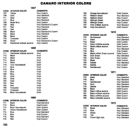

Not sure if these are what your looking for or not but its what I found:
http://img.photobucket.com/albums/v9...ColorCodes.jpg
