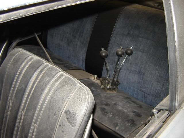

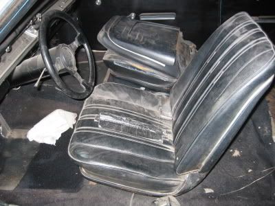

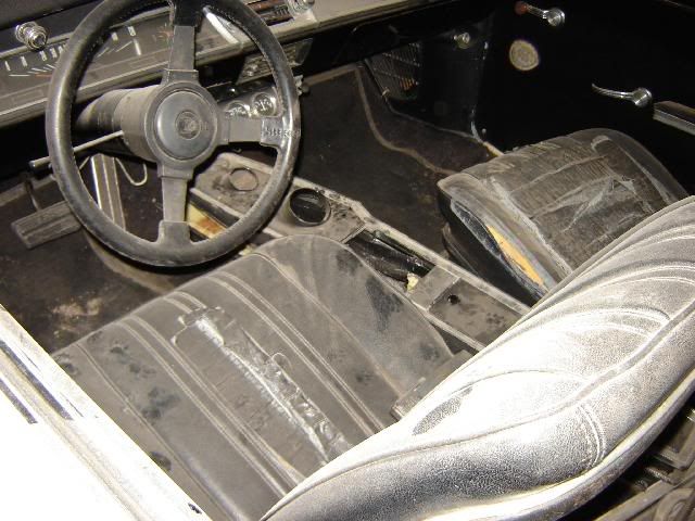

Today I began removing the interior...or what was left of it. Here's what I started with (1st 2 pics are from the website ad)
http://i33.photobucket.com/albums/d7...wchevelle4.jpg
http://i33.photobucket.com/albums/d7...wchevelle5.jpg
http://i33.photobucket.com/albums/d7.../interior1.jpg

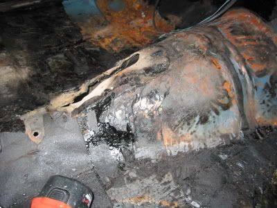

After removing the bucket seats and the carpet, I was suprised at what I saw...what appeared to be multiple sheets of black tar paper covering the entire floor from front to rear footwells.
Oh joy. https://www.yenko.net/ubbthreads/imag...s/rolleyes.gif
I started to pull them up one piece at a time, only to see that they were thoroughly stuck to the floor. Upon closer inspection, I realized every single sheet had been stuck down to the floorpan with what appears to be heavy roofing tar! https://www.yenko.net/ubbthreads/imag...emlins/eek.gif https://www.yenko.net/ubbthreads/imag...s/confused.gif
Out come the heavy-duty scrapers, a few cans of carb cleaner to help loosen things up, and a hammer to help persuade things along.
(I should've snapped pics of what I started with, but I didn't want to gunk up my camera and the GF was busy in the house)
So I dug in.
2 hours later, I cautiously asked the GF if she'd mind lending a hand. She reluctantly agreed.

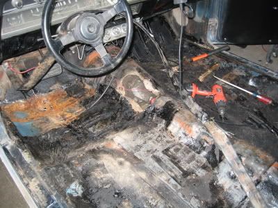

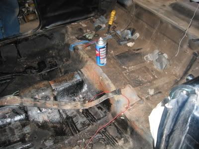

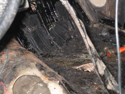

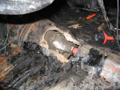

Here's the results of roughly 4 hours of scraping, peeling, hammering and wire-brushing the floorpan:
http://i33.photobucket.com/albums/d7...glassmatti.jpg
http://i33.photobucket.com/albums/d7...hifterhole.jpg
http://i33.photobucket.com/albums/d7...randtarpap.jpg
http://i33.photobucket.com/albums/d7...atflooring.jpg
http://i33.photobucket.com/albums/d7...iorremoved.jpg
Notice the nice rust hole in the drivers footwell. It was covered with a thick layer of fiberglass matting and tar paper.
So far I've removed an easy 40 lbs of tar paper and roofing tar from the interior floorpans. There's probably another 5-10 lbs to go, but I'd had enough for one day.
Thank God for a GF who doesn't mind pitching in and getting her hands dirty. https://www.yenko.net/ubbthreads/imag...ns/worship.gif
I'll try to finish removing the goo tomorrow and assess how much metal it's going to take to patch both footwells and the mangled shifter hole opening.

Yes, the Lightning Rods were still in the car. They, along with a few other odds & ends are going to be up for sale soon to try to help offset my losses on this car.

Nice, lightning rods. Pro stocker. They removed the shifter hump, and hogged the hole for the rods installation. I believe you'll need to replace the hump. The outline is still visible at the front edge of the tunnel. Usually the worst areas on that year chevelle is behind the front, and rear tires. The frame takes a beating in those areas, and the body mts are right there. The rears collect dirt, and moisture and tend to be a trouble area. If the floor pans are seedy,ie; lots of small pin holes, I'd seriously consider replacing them.

For the time being, it will get a rolling resto...i.e. interior, drivetrain, suspension rebuild, paint & cosmetics. Perhaps over next winter I *might* pull the body off and do the frame & floors the way they should be.

Amazingly enough, the frame & body mounts on this thing are nice. The only rust issues I've found so far have been the footwells and some minor scaling in the trunk...no big deal. It's even solid at the base of the windshield & rear window.
