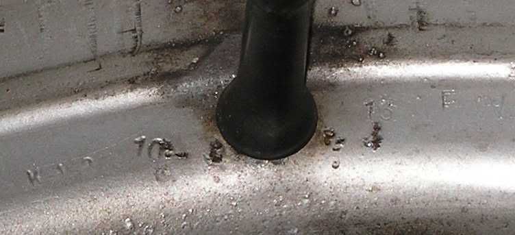

I have a set of 4 15x7 rally wheels that I will be looking to sell soon.
I have been asked repeatedly what they came off of. All I know is that they were on an S-10 when I got them, but I was informed that Chevy never used rallies on trucks.
Here is what the code looks like:
http://i10.photobucket.com/albums/a1...215/wheel2.jpg
Any thoughts? https://www.yenko.net/ubbthreads/imag...lins/dunno.gif
Thanks

If that's an "FW" stamping, you have 1973 Monte Carlo 15x7 rims assembled on October 13th, 1972. Looks to be:
K-1-2 - Kelsey-Hayes, Romulus plant, 1972
10 - October
13 - 13th
FW - 15x7 Monte Carlo Rally Wheels
Ed

Ed, I have four 15 X 7 rallye wheels stamped K 1 5 8 12 FW. Would they be '75 or '76 Monte Carlo wheels? Thanks. Tex Timberlake

These would probably be for a 1976 model since the date comes out to August 12th, 1975. And by the way, the "FW" wheels were used on both Chevelle's and Monte's for 1976.
