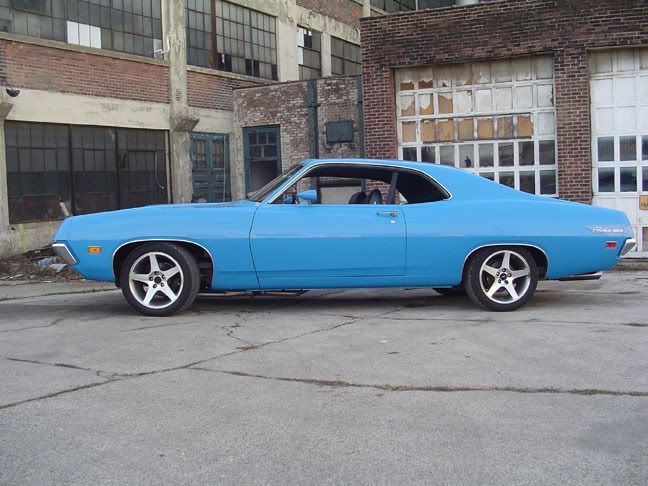

For anyone curious:
My car. 466CID/C6 9" rust free Texas 70 Fairlane. Originally a 302 car.
http://i95.photobucket.com/albums/l1...t/DSC05256.jpg
http://i95.photobucket.com/albums/l1...t/DSC05252.jpg
