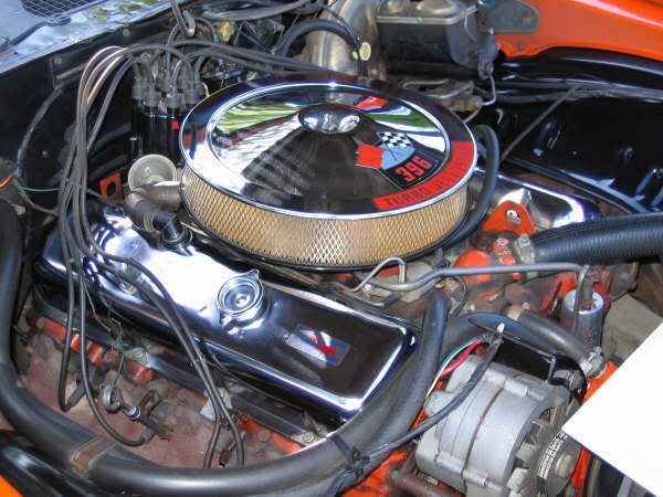

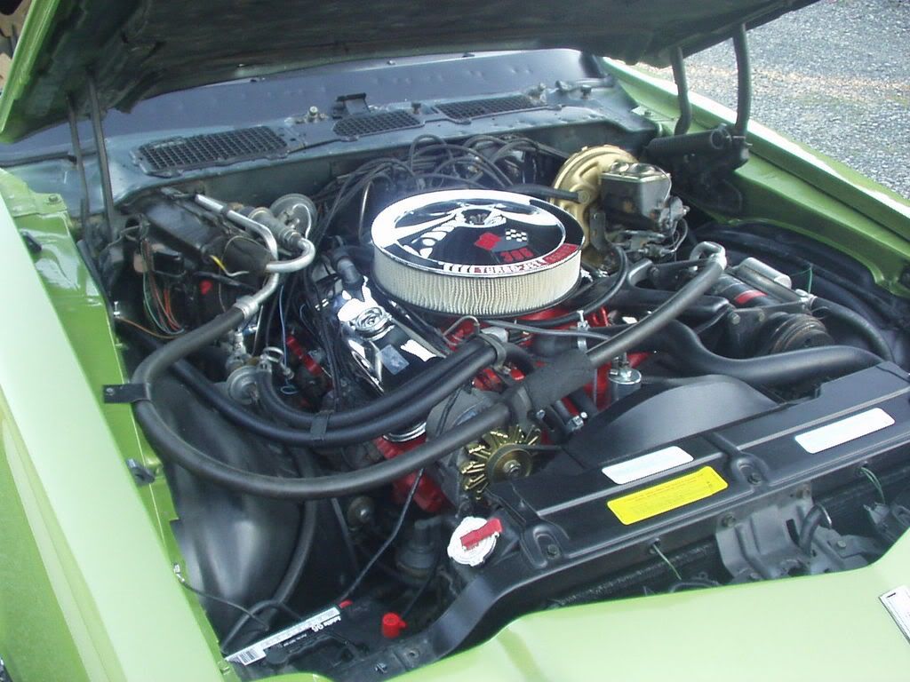

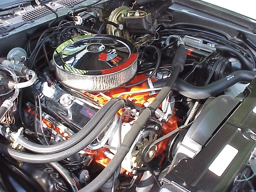

Below are three pics of three different 1970 L-34 Camaros showing ORIGINAL 239 Open Element A/C's
http://img.photobucket.com/albums/v4...int2004007.jpg
http://img.photobucket.com/albums/v4...RightFront.jpg
http://img.photobucket.com/albums/v4...rstwash001.jpg
http://img.photobucket.com/albums/v4...s/IMG_0339.jpg
Thanks,
