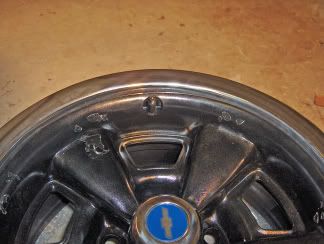

I just bought 4 wheels, and yes they have the right valve stem hole. How can I tell what they were on and what year? I'm used to 69-70 Chevelle SS wheels. Any help would be appreciated.

let's see if I learned my NastyZ28.com lesson... The hole for the value step will say "AU" and will be a round circle not an oval shaped, egg, "hole." Originals are rather tough to come by but "aftermarket" or should I say later editions are similar/incorrect but good for driver wheels/tires.
Good luck, Dan Did I get it right 2nd Gen Camaro guys? |

let's see if I learned my NastyZ28.com lesson... The hole for the value step will say "AU" and will be a round circle not an oval shaped, egg, "hole." Originals are rather tough to come by but "aftermarket" or should I say later editions are similar/incorrect but good for driver wheels/tires. Good luck, Dan Did I get it right 2nd Gen Camaro guys? [/ QUOTE ] I am not sure I understood what you said. So I will take a shot at it: early 1970 wheels have a 1 by 5/8 oval valve stem hole, all others up to and including 1974 have a 1 by 13/16 oval hole and 1977 and up have a round hole. Late 70-74 http://i22.photobucket.com/albums/b3...irstDesign.jpg http://i22.photobucket.com/albums/b3...rstDesigna.jpg 77 and up http://i22.photobucket.com/albums/b3...d/HPIM0598.jpg http://i22.photobucket.com/albums/b3...condDesign.jpg Sorry, I don't have a early 70 wheel to show you. |

To answer your original question about dating go to this site: http://www.nastyz28.com/2gcog/stegmiller/z28_wheels.htm

My mistake, I said the valve step hole information backwards... was a long day. Sorry for the confusion. Thats what I get for being removed from the second gen community.

Chevy by the Numbers has a good section on factory KH wheel decoding https://www.yenko.net/ubbthreads/imag...lins/beers.gif
