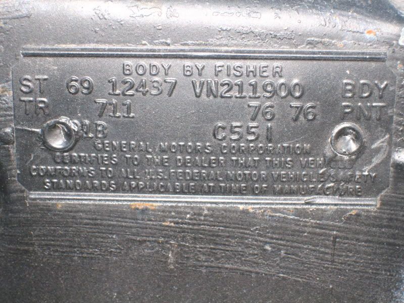

I would like your thoughts on this TT:
[image]http://i50.photobucket.com/albums/f3...r/69RSZTT2.jpg[/image]
[image]http://i50.photobucket.com/albums/f3.../69RSZTT22.jpg[/image]

Real or Fake? What is the C551 on line 3?
ken_z 04-13-2008 09:49 AM
Re: Opinions on this Trim Tag
You probably already know it's an LA built car. black
standard interior, daytona yellow and a V8. C551 is an
LA only scheduling code. I picked up the last bit from
camaros.org, since I have an LA built '69.
Ken
firstgenaddict 04-13-2008 12:07 PM
No reason to make a fake... unless it was just a replacement... VN cars have no info on the TT that would warrant a forgery.
Jonesy 04-13-2008 06:27 PM
There are fake Van Nuys tags out there. To have a more desirable Color or interior is the main reason. This one looks real, but may have been off the car at some time judging by the way the rivets look.
Ngtflyr 04-13-2008 10:08 PM
BTW this is a RSZ28, I believe it is a real tt, the car has original paint except where some body work was accomplished, so no need for a color change TT. The car has been off the road since 1980 was partially torn down to restore. Guy who had it started a family, and ran into the typical time, kids, $$ constraints. He had to sell the car to pay taxes. I've been trying to buy it for some time now. I had heard the C551 was a LA scheduling code, anyone know anything about these codes? BTW it's a RSZ28 and with a lot of time and $$ will be nice. Came with a DZ motor, but not the original. Some rust issues will require minor sheet metal replacement. I will soon post pics and show what I am starting with.

The C stands for the 3rd day and it was the 551 car that day to go to the line. I cannot tell what month the car was built as the pic is not good on my screen.

It's a 91B, C 551 or Jan (1), 1969 (9), 2nd week (B), 3rd day of the week (C), 551 car of the day? or the 551st car built on 10 Jan 1969.
Jonesy 04-14-2008 12:48 AM
Its 01B, which is 2nd week of January.
C551 is the VanNuys body scheduling code.
Its the 551st body during the C period.
C isnt the 3rd day of the month. It all depended on when (what day) the "C" build week started. They also built fullsize chevrolets at the same time.
