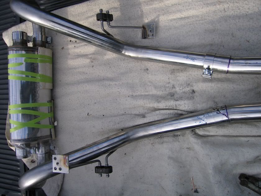

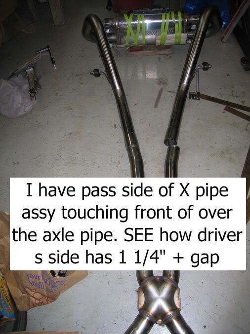

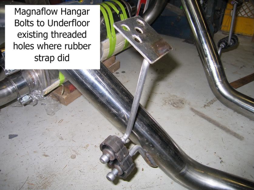

CamarosRus 05-26-2008 01:19 PM
Re: Exhaust : Factory look with an aggressive soun
I'm in the midst of installing the MAGNAFLOW 15895 Crossflow 2 1/2" Stainless Steel mandrel bent X-pipe system.
Not disputing PYPES sound or performance, but didnt like what I read about muffler alignment on Camaros.net threads.
MAGNAFLOW muffler will hang parallel with diff and square with body. MAGNAFLOW' supplies hangars that bolt to existing OEM hangar locations in front of mufflers.
Tailpipe hangars are poor and I've yet to come up with a solution.
MAGNAFLOW tailpipes end simliar to 67-68 Camaro. PYPES sells a polished slip fit extension. I plan to butt weld polished 304 stainless to my MAGNAFLOW tailpipes to replicate the 69 look.
Anybody interested can Email me with questions, as I'm fast becoming the install expert for this system.....
