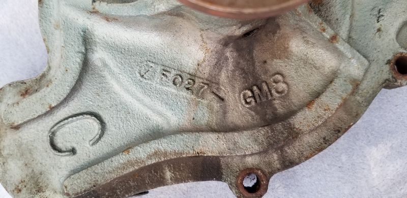

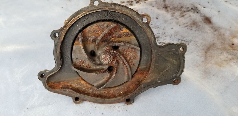

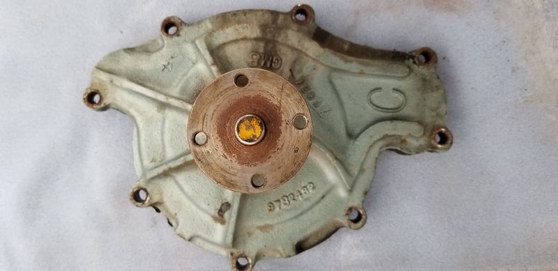

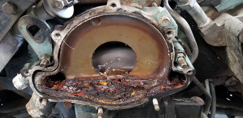

Day off today and its raining here, good time to post some more photos. Started in on the engine a week or so ago. It looked really nasty initially after removing the original water pump, but there must have been just enough coolant in the system that all of the crud came off easily and didn't damage the timing cover or pump. The divider plates are toast, but those are easily replaced. It looked to have the original thermostat in it that reads "Delcostat". As I expected, the original aluminum/nylon tooth cam timing gear was still in place, but the nylon was completely gone! I've heard over the years that many of these Pontiac nylon gears failed under 20K miles and were done under warranty, but somehow this one kept running and never jumped time. And check out this "storage" decal that I found on the passenger cylinder head behind the smog pump bracket, never seen one of these before.
