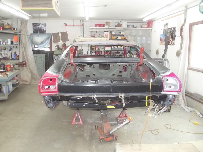

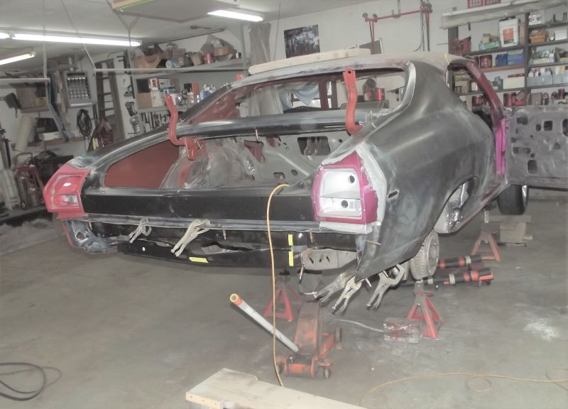

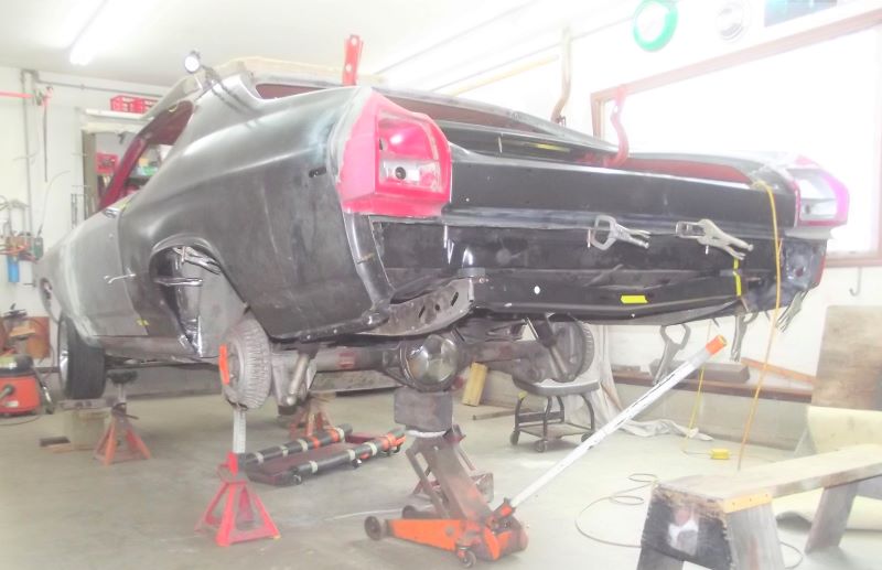

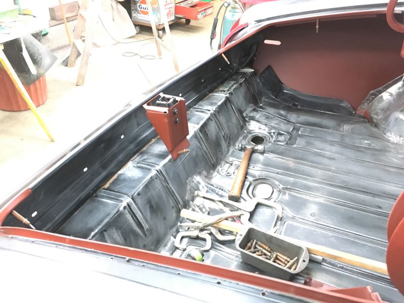

More. All the metal, less the GM NOS quarters, is AMD metal. Fit was VG with only a couple minor tweaks. Also take a look at the rear frame horizontal member. The original was distorted from a minor hit in the back at some time, it could have been saved but for 123 bux the AMD replacement was awesome. All the AMD metal was full gauge like OEM. Trunk drop off extensions as well.
Phil Woj supplied the left tail light housing and it just happened to be from a Garnet red car, the right is the original to the car.
Along the way Phil helped out a bunch with parts and advice with this build, it kept the Camaro guy from screwing up to much.....
