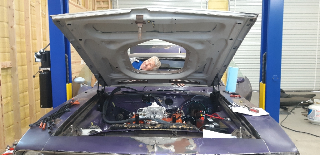

Welp, cam break in was successful....sort of. First step was to wire everything up, which you'd think would be easy. I mean, eight wires, right? Wrong! Despite being date coded correct and all that, they're about an inch short on every plug. But as one can see by the expression on my face, I didn't let that stop me!
