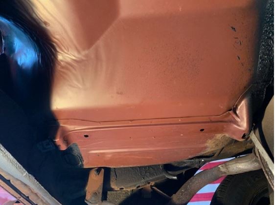

Update: Took the Formula out last week (Saturday), put some fuel in to it and over the course of the next mile, stalled several times. I put about six gallons in it however JJ (seller) was pretty up front that the fuel was old that was in the car. The car ran well during face time inspections and face time test drives and when it arrived however after introducing new fuel in to the system, it started acting up. I pulled the fuel filter and it was filthy so I decided to go deeper just so I was not putting a band aid on a bigger problem. I siphoned most of the fuel out and it was not really fuel at this point, discolored and more debris than I could have planned.
Over this week end, I dropped the tank and it was pretty dirty inside, the filler neck has a good amount of loose scale so my thought is that when I put fuel in to it, I introduced more crap in to the fuel and it was sucking it in, stalling and then once whatever is in there moved, it would restart, enough to get about a tenth of a mile before it would pull whatever it is back down.
At this point, I am going to replace the tank, the bottom of it and the seam is not in great shape. Replacing the fuel sending unit which I knew it needed as well as the fuel pump and will make sure the lines are clear from the pump back before I do any reassembly. Will also clean out lines carb to pump.
With only 7900 miles, this was part of the plan anyway and something I wanted to do just to make sure that the whole fuel system was on par with the rest of the car.
I did send a note to the Seller in FLA and he as beyond accommodating. He said keep track of your time and the parts and he would reimburse me BUT I told him that was not necessary and that I had anticipated that I would be doing this anyway when I did the sending unit.
In fairness to the seller, I did ask about the age of the fuel and knew it had not been driven much/at all in the past year plus so did not feel like I needed to recover anything. AND yes, my error initially, I should have given the system a good check before even putting fuel in it, was just a bit over eager.
Any additional inputs on this? Replace tank, sender, fuel pump, filter and blow out lines with carb cleaner and light air pressure. Hoping the Carb is fine (it was rebuilt by a noted carb person) though that may need a going over, last piece of the puzzle.
