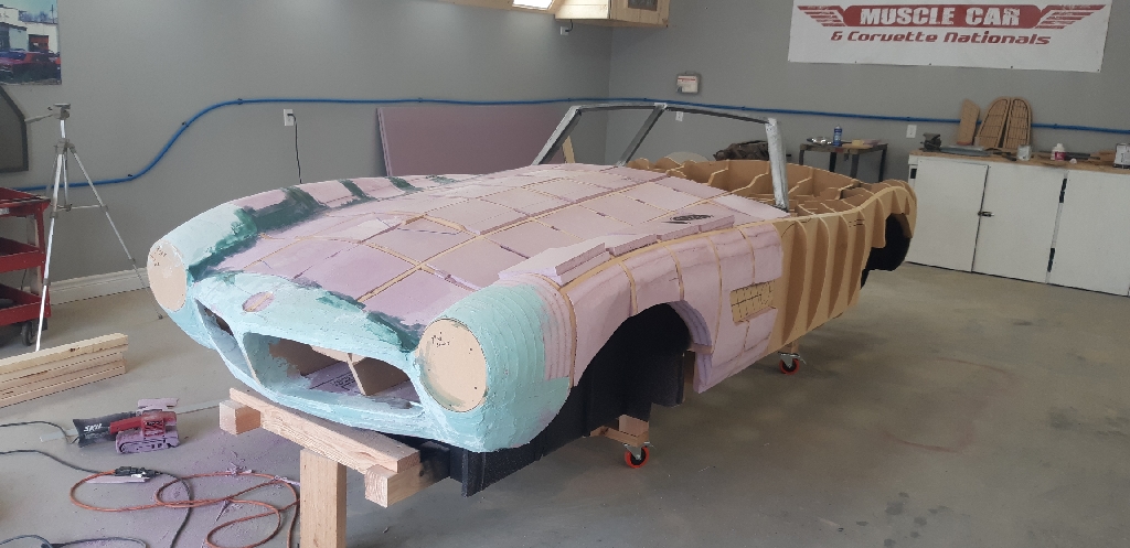

The weekend has been foamtuitous with progress! I'm about 2/3rds of the way done with the initial foam carving. You can really see the lines now! The green is fiberglass impregnated filler which fills the seams and bonds the foam together. The other is just regular filler. The CAD scan gave me the hood line reliefs as well as the scoop position. No guesswork as to it’s location.
I’m thinking now my plan will be to make molds and then assemble the body as one piece. The nose will be a section, the left front and right front will be two more followed by the doors and rear. That way if I decided to build another (a his and hers version) I could easily make another body if needed. Or, I something happens and I need a repair panel. See? I’m already thinking of my first crash!
I hope to have the body sculpting complete this week!
