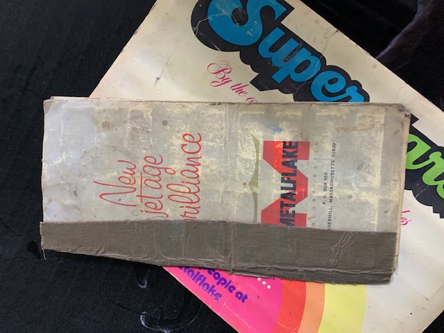

Back to topic.....Rick and I spent some time talking about the paint he used on Rat's Nest BITD. He was not able to locate any leftover paint in his shop like I discussed in an earlier post about the tail panel color. He did go to an old file cabinet and pull out this color card booklet by MetalFlake Corporation. He opened it up and showed me the exact paint colors used on the car. He said he painted the whole car with the white base, then did the entire car in silver mist pearl, taped off and sprayed the Iced Blue pearl, taped off and sprayed the Fire Red candy apple. All in lacquer, then topped with several coats of clear. We talked quite a bit about how all the photos show the silver as very "white". He said that Doug did not like how some of the white pearl paints had that goldish/tan cast to them so they went with the silver over a white base.
The Rat's Nest name was hand-applied by Tom Blackstone "Stoney" (deceased). The letters were gold leaf with a white outline.
