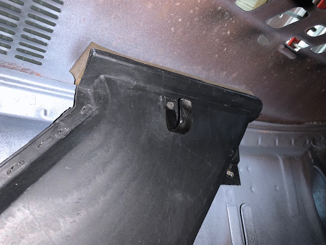

When Graeme over on the Air Force Brat thread mentioned he forgot to install the Y-duct before the heater box, I realized I had made the same mistake. So here's some pics of that component installed. The foam seals are the originals, they were still flexible, I just had to apply some adhesive to keep them in place. I think my car was assembled on a Friday, so that might help explain this The front defroster "Y-duct" had the fastener on the passenger side miss it's mark. Screwed adjacent to the correct hole creating a corresponding extra hole in the dash structure. This car also had the driver rear quarter window adjustments assembled without the adjustment nut. Guess the guys were ready for Beer-thirty
