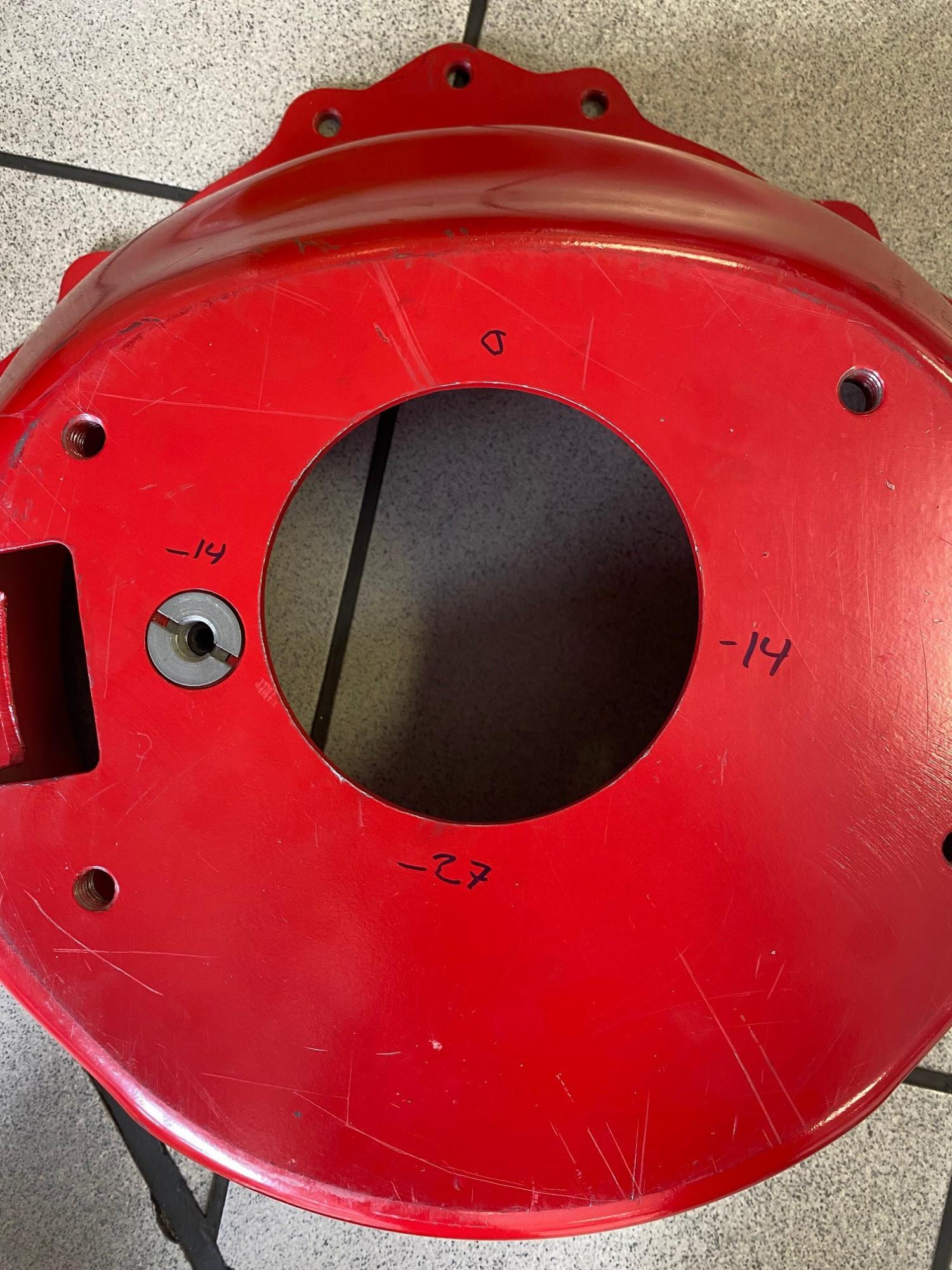

Thanks for your interest Tim! I do have some updates but where do I begin?? I know I've been MIA for a while. Looks like we left off with the rear end and rear suspension. So a while back I scored a good deal on an a 30 year old Lakewood splatter, I mean SCATTER, shield and block saver. It is NOS. Pretty neat piece with a 1991 SFI sticker, not quite Day 2 but less money than a brand new piece. It was essentially brand new with box, hardware and instructions all intact. My buddy and I bolted it up and thought well how do we adjust the adjustable screw in Lakewood pivot ball.... I mean we know how but where do adjust it to... Time for a little YouTube University THANK GOD Al Gore invented the internet!! Discovered the proper measuring technique and also saw the guy in the video dialing in the bellhousing to the crank centerline. I remembered doing this on my 68 with a Tremec TKO 600 transmission so figured what the heck might as well check. Good thing I did because it had .0135" runout. I decided to call Autogear and they notified me the tolerance is .0100" and recommended RobbMc performance dowel pins. I'm so glad they did because I probably wouldn't have discovered them otherwise. Easily adjustable and installation was a breeze. Got the runout to within .001"!!! Installed the 30lb steel McCleod flywheel, and McCleod Super Street Clutch.

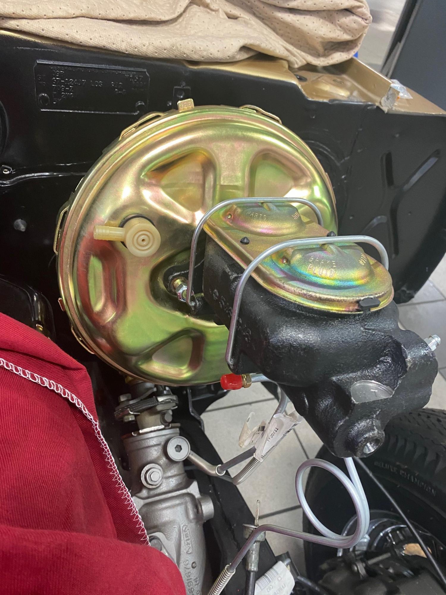

I bought a gorgeous brake booster from Mike Gibbons, since a reproduction unit just wouldn't cut it for this build. My car did not have power brakes from the factory. Mike worked with me to find a pretty close date code to my car, the booster he sold me is dated 254. Car is dated 09B so close enough. I'm not trying to claim the car has original power disc brakes, I really just want as many factory parts as I possibly can.
