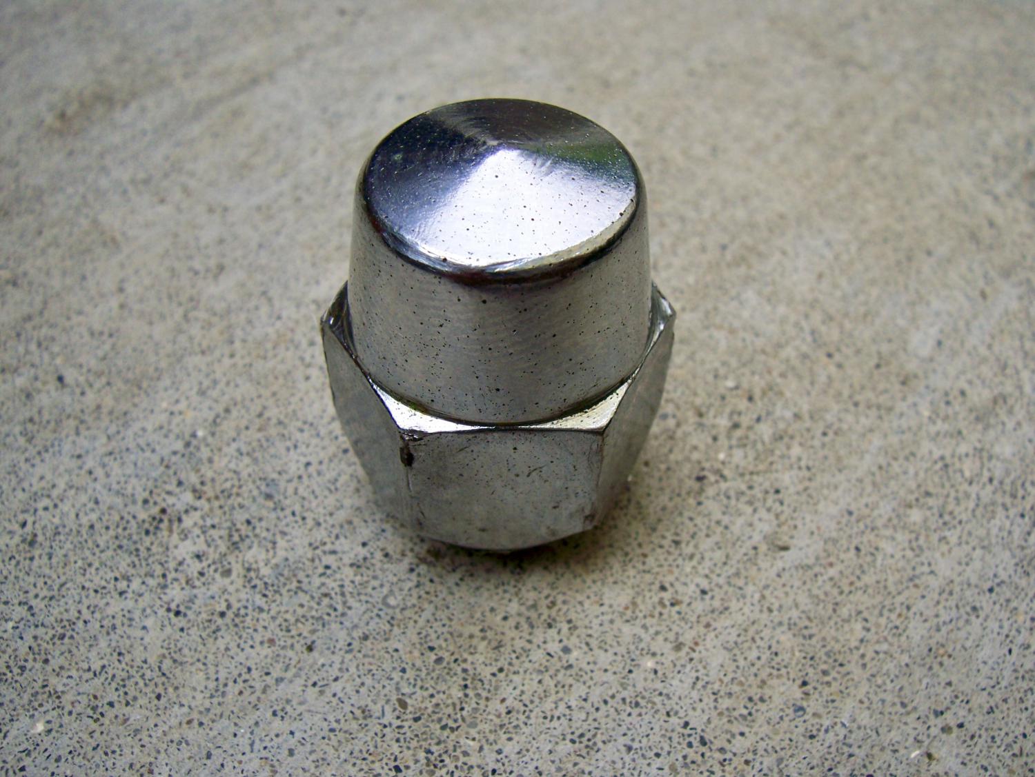

The wheel lug nut is also unique for this Rally I wheel.
It is a solid chrome (Not a S/S capped nut) Hex Crown as shown.
These are also very difficult to find.
