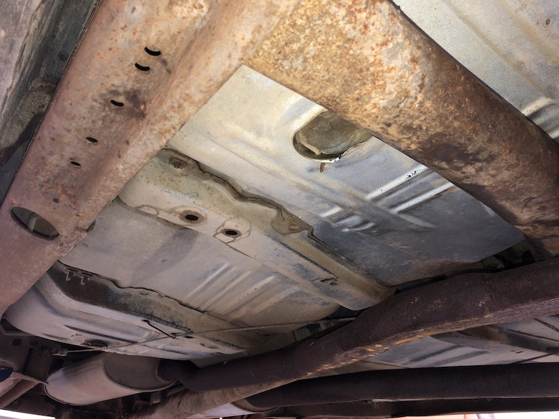

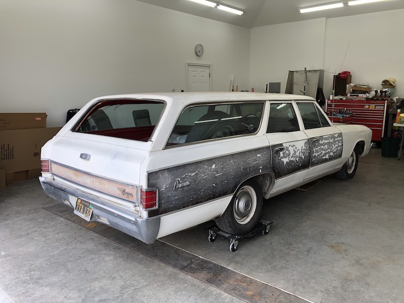

This Concours wagon is original metal in excellent condition except for the pass side fender, which is a used OEM from another car, painted to a fairly good match but no trim.
First priority was to get it up on stands and clean the underside. I didn't spend a huge amount of time under here, mostly just a good pressure wash. Fremont was very generous with overspray on the floors! Note the welded muffler on the original factory dual exhaust system still in place.
