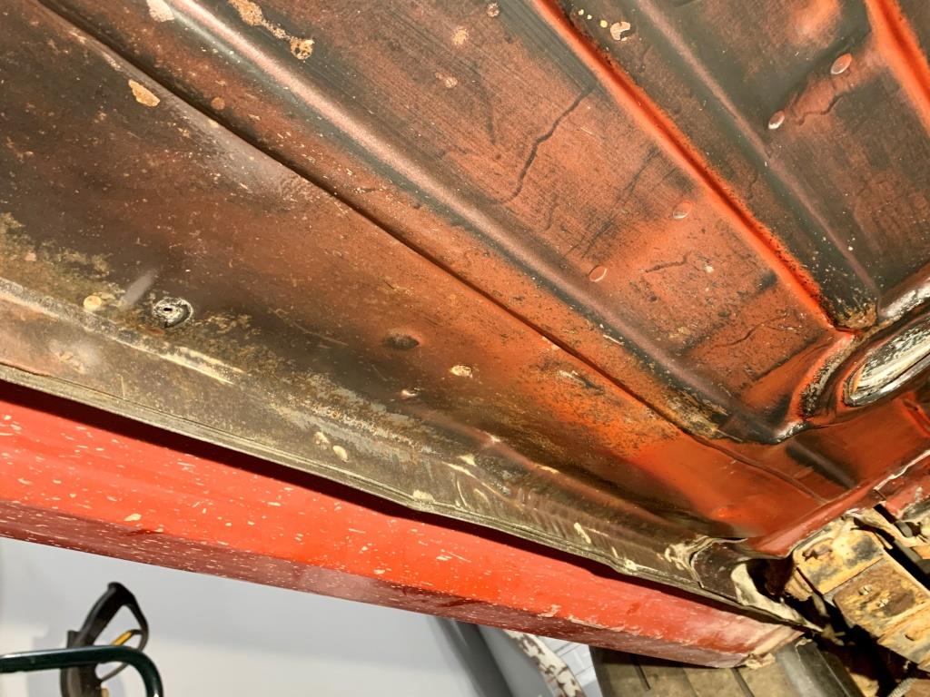

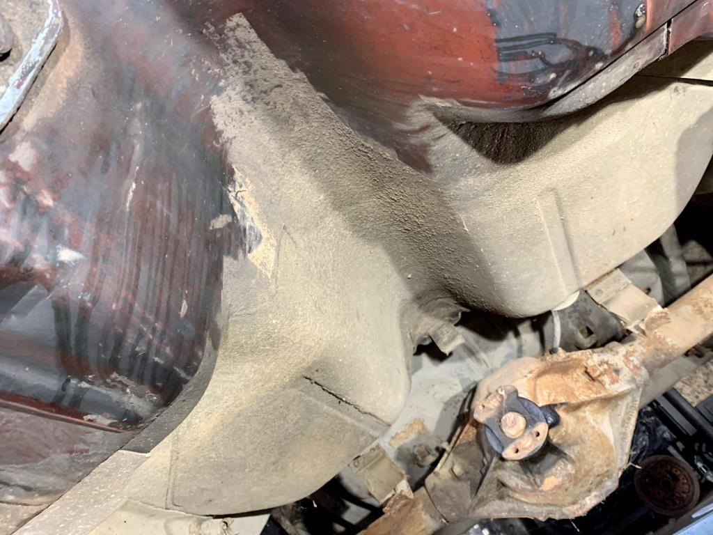

Photo 394 - Rear tubs before cleaning. Not sure if there is a difference in Texas dirt and TN but this was very compacted. I found success with soaking it down with my favorite citrus degreaser and then gently peeling of the layers with a razorblade on the flat surfaces making sure not to damage the original finish.
Photo 395 - 398 - After removing the majority of the dirt with the blade I hit the surfaces again with degreaser and then gave it a work over with a blue Scotchbrite pad. Once the surface was bare and clean I then coated it with Meguiar's #7.
Photos 399 - 401 - Finished product - I still need to go back and hit the pass side front tub in the photo with the red arrow.

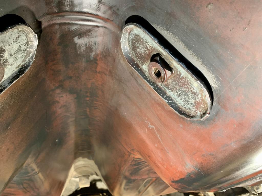

Went ahead and knocked out the passenger compartment last night. Overall, I am very happy with the condition of the floors considering the amount of caked on Texas and TN dirt. Next, I'll move my attentions back to the firewall and then on to the subframe.
Photos 402 - 403 - Finished pass compartment floor. After cleaning with the aforementioned process; I applied a healthy coat of Meguiar's #7. Oh and I received my plastic razorblades I ordered and they seem to work ok for the cleaning of dirt and grease but I'll put them to the test on removing heavier layers.
Photos 404 - 405 - toeboards and front floors.
