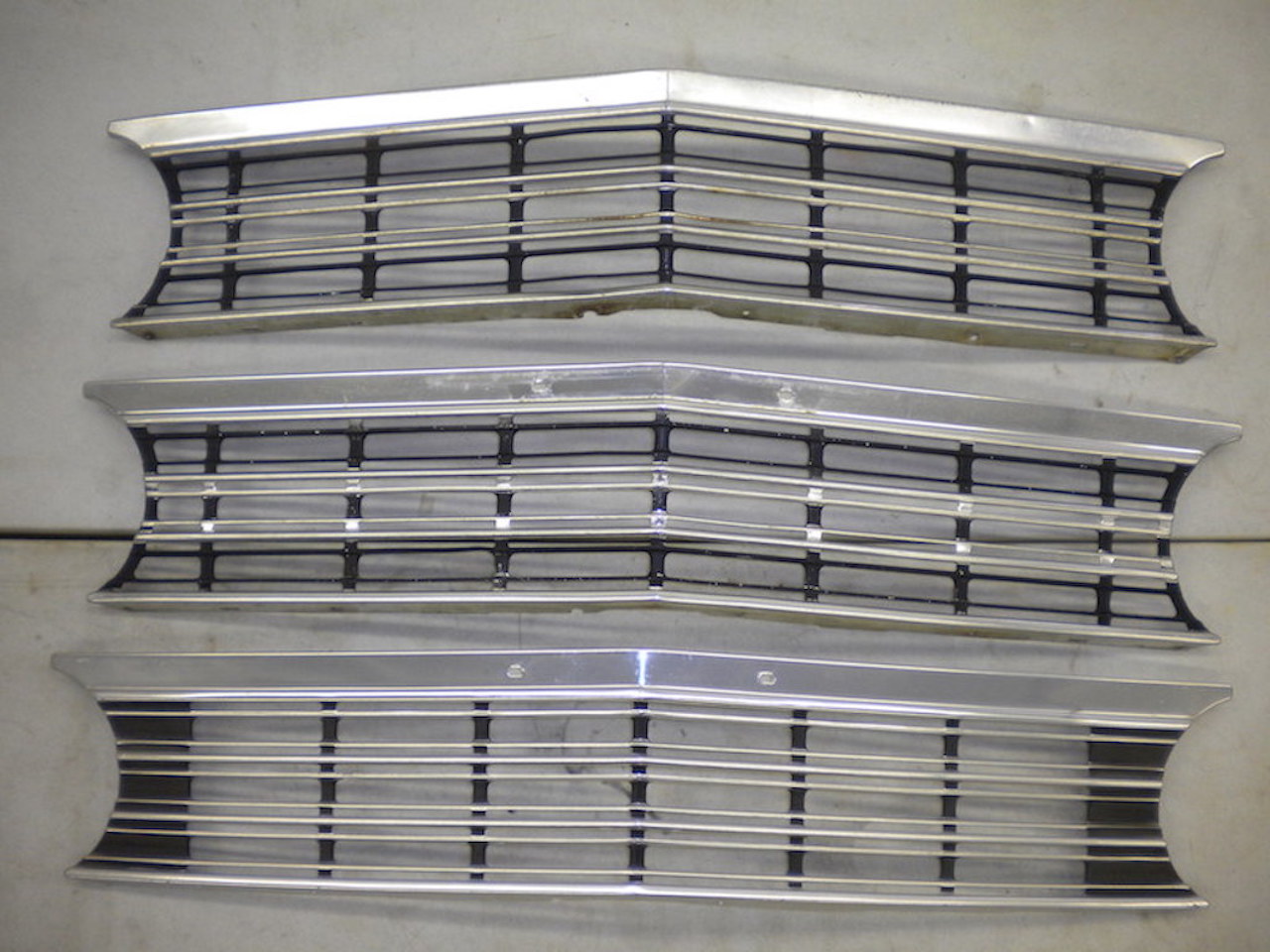

----Bill,,,Can you expand on the grille trim for the end panels with the holes? I owned a 67 SS new and really can't remember that. Maybe a close up picture as well of my favorite wagons pieces.....Bill S
I'd be happy to explain this Bill! I furnished this image for one of Dale Macintosh's books.
The grille on the bottom is found on all '67 Chevelle trim levels and El Camino EXCEPT SS396 coupe, convertible, and Concours wagon.
The top grille is SS396, note the open slots on the ends, a few more bars blacked out, and no pierced slots for the top center emblem.
The center grille is Concours wagon only. Note the open slots and extra blackout like SS396, but has pierced slots to mount the top center grille emblem.
So the Concours grille is essentially a Super Sport grille with top center slots added and unique to that model only.
