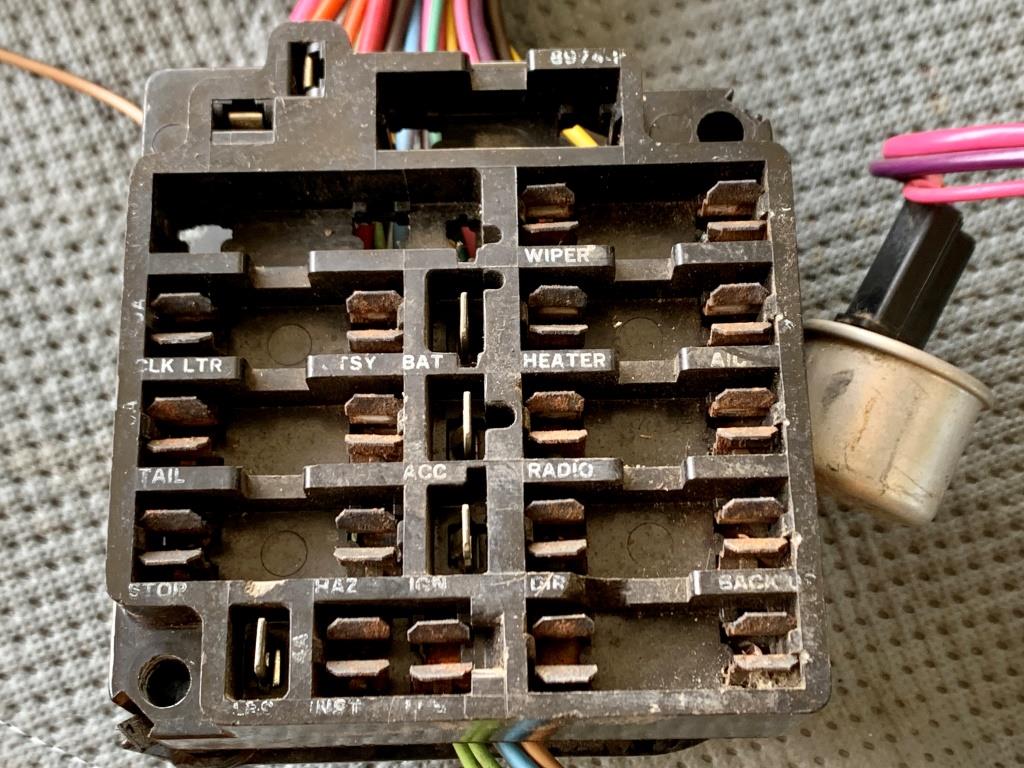

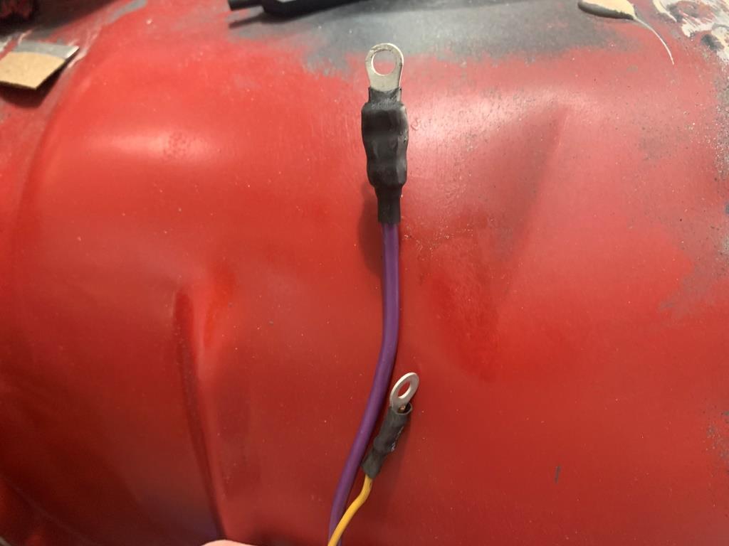

Small updates. Cleaned the fuse box and reinstalled what fuses were in it when pulled from car. Replaced the starter wire from a spare harness I had. Repair was done with interlocking the wire ends and soldering the connection then covering with heat shrink followed by wrapping the wires back with original style tape. The ends were crimped and heat shrinked as well. Also applied a healthy coat of RPM (Rust Prevention Magic) to the pedal assembly and reassembled.
Photo - 503 - Fuse box before
Photo - 504 - Fuse box after with fuses installed
Photos 505 - 506 - starter wires repaired and a comparison to original.
