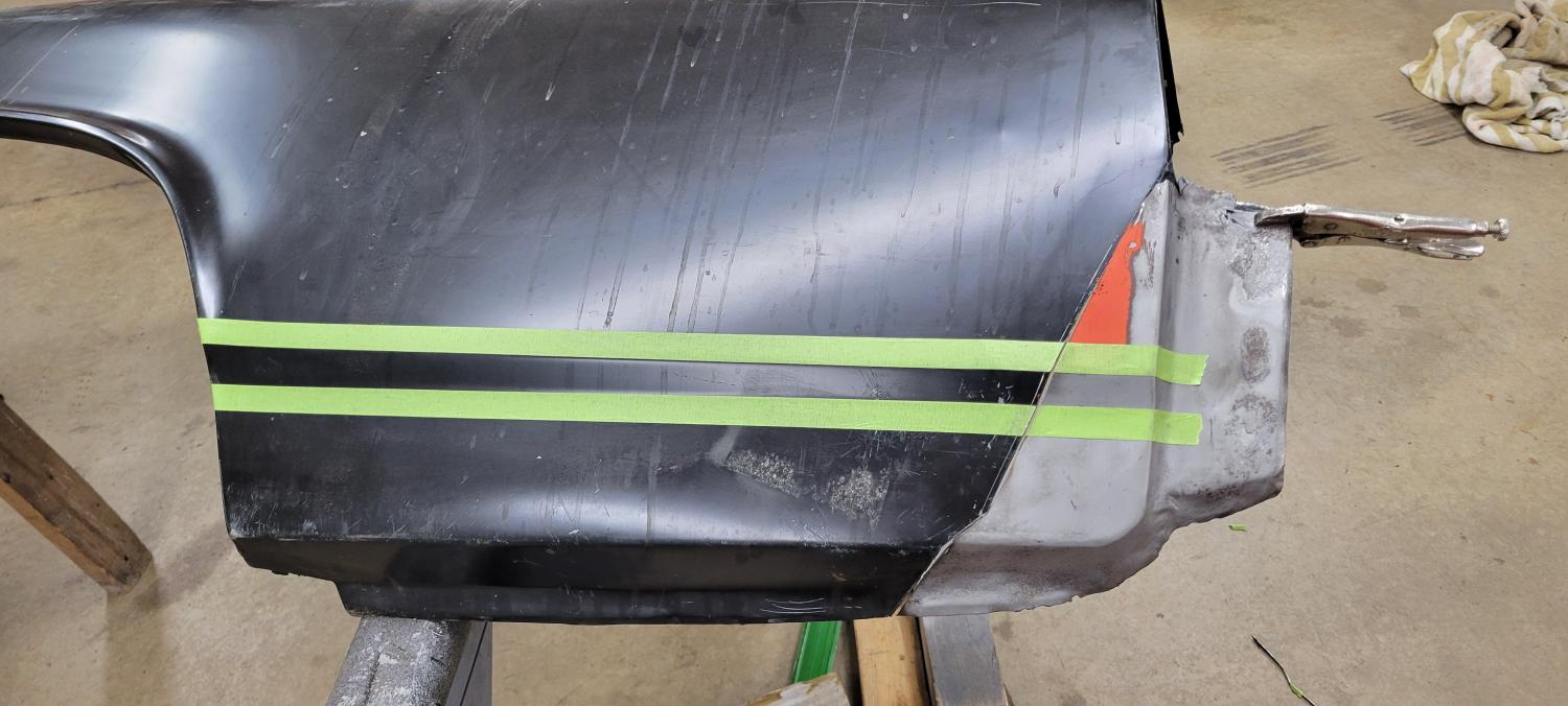

Default How To Turn a 68 NOS Quarter into a 69
Several years back i got a full set of 68 NOS quarters for next to nothing compared to todays prices. I have a 68SS waiting to be restored but its a New Mexico car. It has zero rust so I didnt have much incentive to hold onto them. As many probably know the area where the bumper fits on both 69 and 68 is quite different. The 68 rear lower quarter at the bumper is angled to match the bumper while the 69 is pretty much straight up and down. This procedure was one where I had to take my time, measure, cut, measure, cut, cut some more, cut again, pray a tad and then very slowly weld the two panels together. After grindin down and smoothing the area I just hammer and dolly to get it so nothing but a sliver of body filler will be needed to achieve a perfectly flat lower quarter section. I probably spent a full day just working on this, but it came out REALLY good. I will have to do this to the passenger side as well. I always like using the existing other side of the car like a mirror image to check my work. Did some checking with the other rocker/quarter and found things to almost be within a 1/32" which is honestly just dumb luck. Many a times I find things from side to side to be off by as much as a 1/4"
