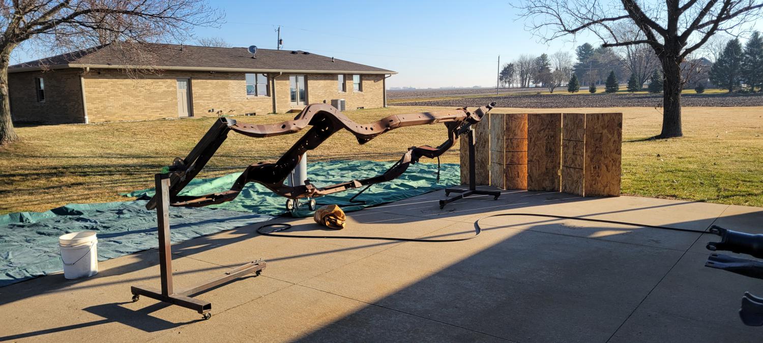

Default Frame Blasting and First Prime
Originally Posted by chevyman0429 View Post
What type of product are you using for your blasting and what are you prepping the blasted surface with before painting ? Thanks
I use basic sand blasting sand and a standup outdoor blaster. For many of you following I dont get bogged down in the details of thinking the most exocitc process is the best. I keep things as simple as I can. In terms of sand I use the stuff stocked at the local Menards for those that live in the midwest. Most here on the forum are gonna die laughing but I still use the old school lacquer based primers. Im not afraid to use the lacqur direclty on the blasted metal. Once I get into the stage of sanding and removing pits 90% of the first coat is sanded off. Body panel work is a total different story. I get into the more better adhering epoxy primers for my basecoat but still layer body filler and lacquire primer on top of that.
Ocassionally i will use a 2k high build primer but I will only get into that with easily sanded surfaces and heavier pitting. This car will not require and 2k as im already finding a single sand is elimating all pits if they even exist.
