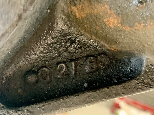

Diff cleaning and preserving is now complete. Installed pinion races and carrier bearings (not pictured and previously axle bearings and seals). Once I get the inner pinion bearing installed I will start the reassembly process. I've decided to go with the solid pinion sleeve and I'll walk through how I set it up etc once the time comes.
Photos 937 - 940 - Diff during the heating and coating of Cosmoline Rust Veto & RPM (Rust Preventative Magic). I heated the differential with a heat gun and applied the mixture with a paint brush and kept heat on it while it cured and leveled out.
Photos 941 - 942 - Center section and the casting date now revealed. C 21 8
