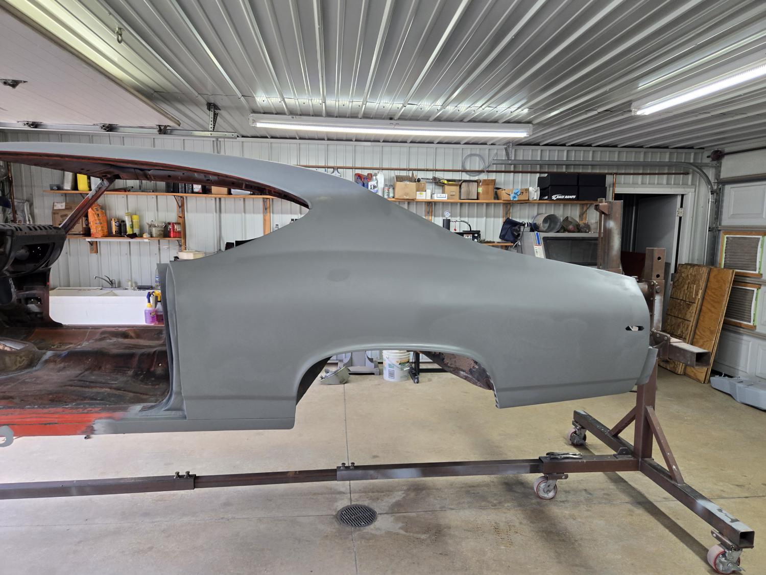

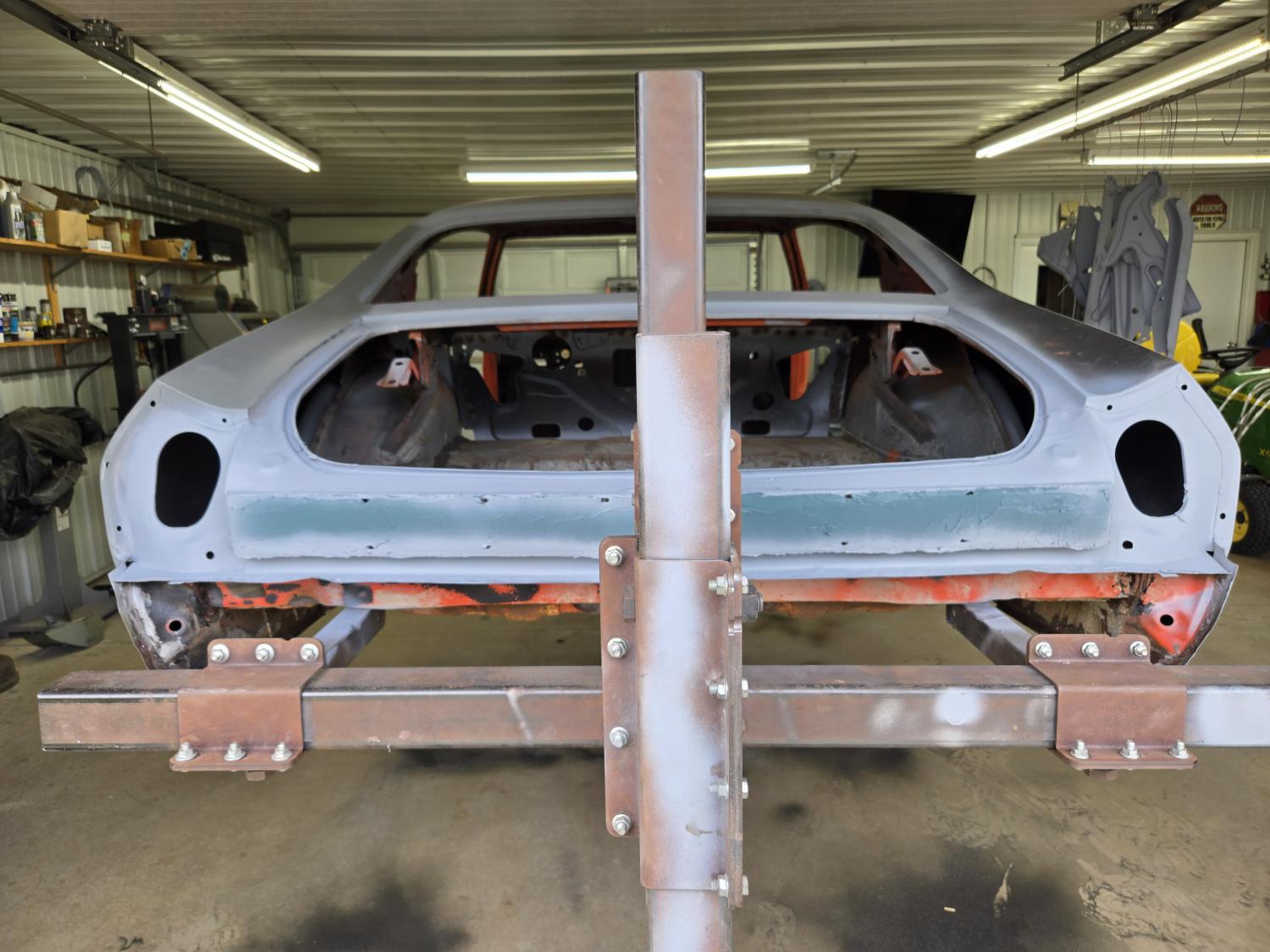

This is just a glimpse into the time commitment required for body work. All panels are stripped and dents worked out, followed by filler to smooth out areas. This gets followed by epoxy primer. Something else that is a pet peeve, NOS sheetmetal is does not mean perfect, and in most cases the parts you get had flaws. This quarter proved to have some serious issues behind the back wheel. Worked out the metal best i could. Also managed to get the tail panel worked, and mudded for a first sand. If your wondering why all mud, its because much like rockers you will never find a straight one. Just the way it is.
