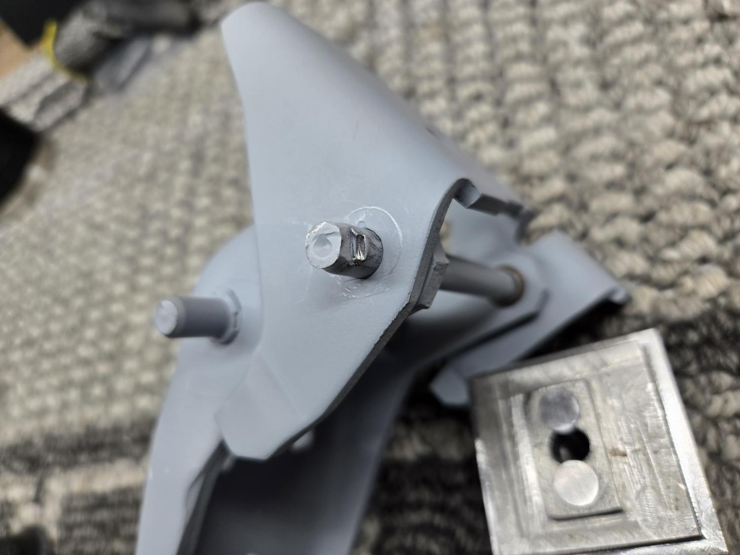

Hinges get fully taken apart. Most of the kits out there that include the bushings work well. I reuse the old pins as they have the circular marks on the pin that the replacements dont. This set was in nice shape and only needed minor filling.
Pins are reinstalled and pin ends swedged out with a die and press.
Got lucky on this set as i reused the pin at the roller. These are usually destroyed and i have to turn my own.
