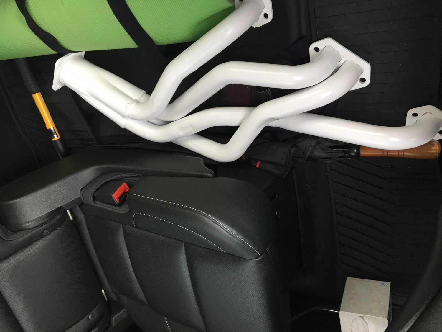

For those of you in the know, what method / vendor did you use to coat your headers in white? I stopped at Aesthetic Finishers this week and was told they do not do white on headers any more because too many customers complained about the durability. I'm looking for something that won't discolor from the heat.
